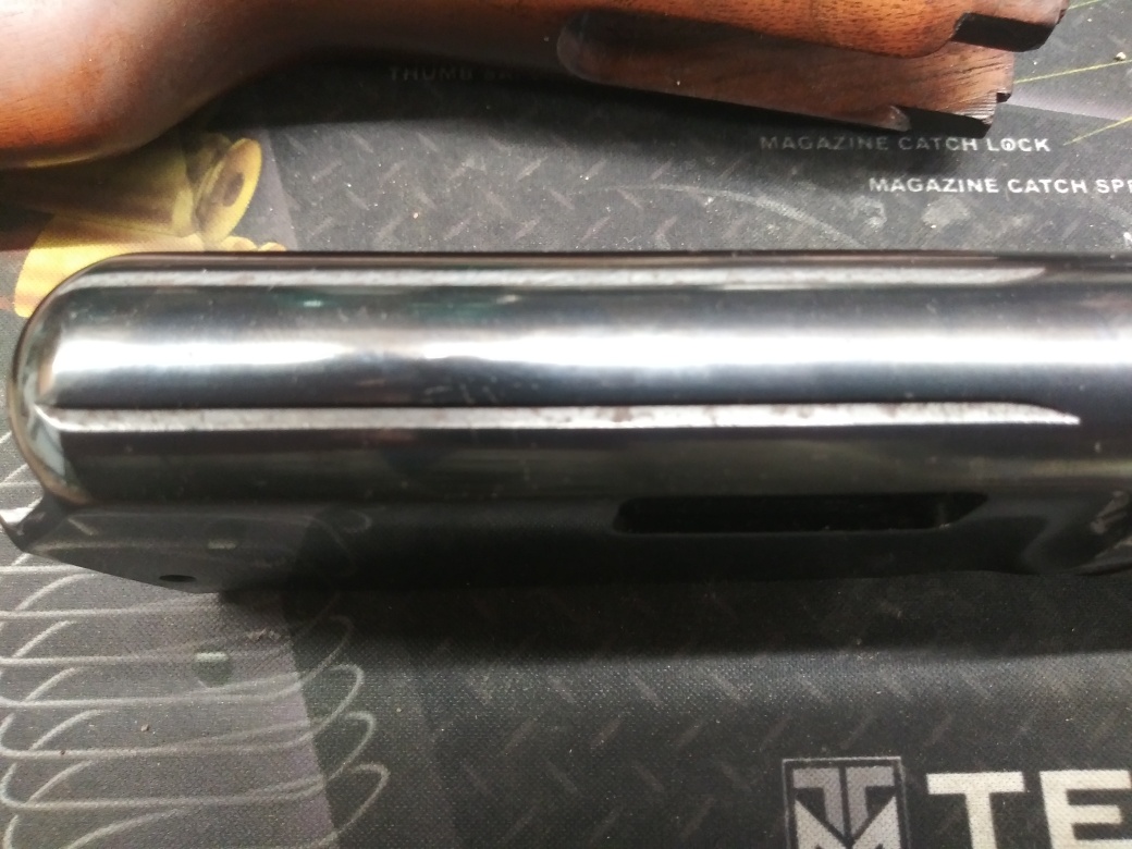

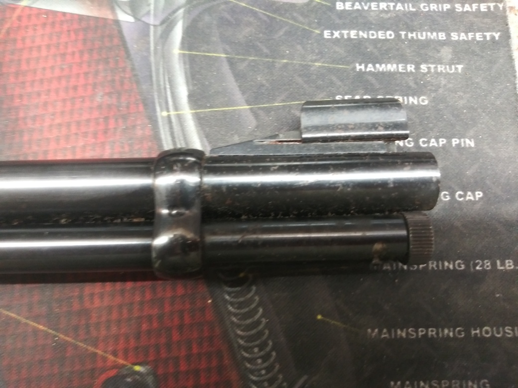

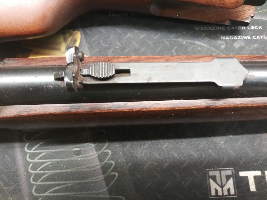

                OK - just finished re-assembling the 9422M I fished off of GunBroker and posted about earlier. Clean-up of the metal was pretty straightforward, and I'm very pleased with the results. Some freckling and so forth here and there, but for the most part the small rust blossoms carded off with almost no issues, and the bluing is still nice. The side of the bolt that is visible from the ejection port had some pitting and staining, but the judicious application of a Dremel polishing felt tip loaded with jeweler's rouge took care of that.

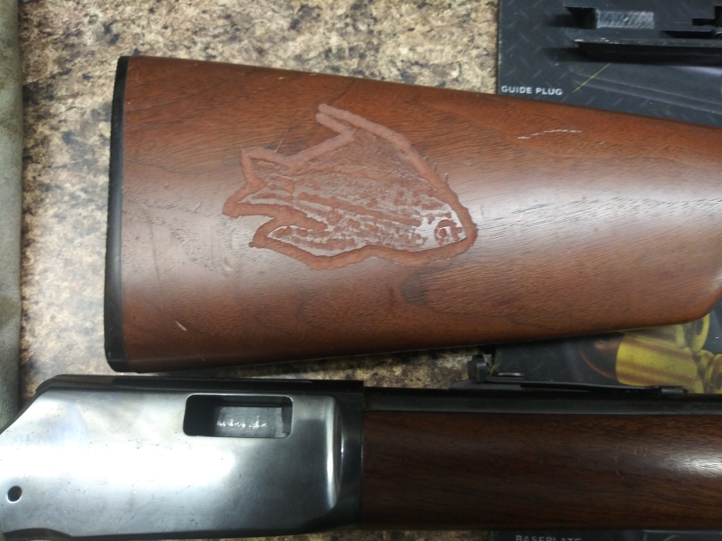

                In the end, I decided to go with the straighter grained butt stock because it matched the fore-stock very nicely, and as a pair they look really nice. I had to sand the front a bit, both to get out some of the small scratches and also to match the color more closely to the new butt stock. I did not sand the butt stock at all because it was already "finished". However, I applied two thin coats of Tru-Oil, knocked down the shine with 0000 steel wool, and waxed it with several coats Bowling Alley wax. I hand-buffed that, and got the satin sheen I was looking for. I think it came out nice, take a look:

                          Thanks. For $800, I think I did OK even though I had to do all that cleanup. The bonus is that the serial number puts it at 1973, so it's an early one. I'm going to try and ping Simpson's tomorrow and see what the name engraving is all about.

                              Looks great, BBM. Do you have before pics?
                                Thanks. I posted a bunch of photo's up-thread, but here are some "before" highlights (and I'm working on the pics of the Legendary Frontiersman for you):
