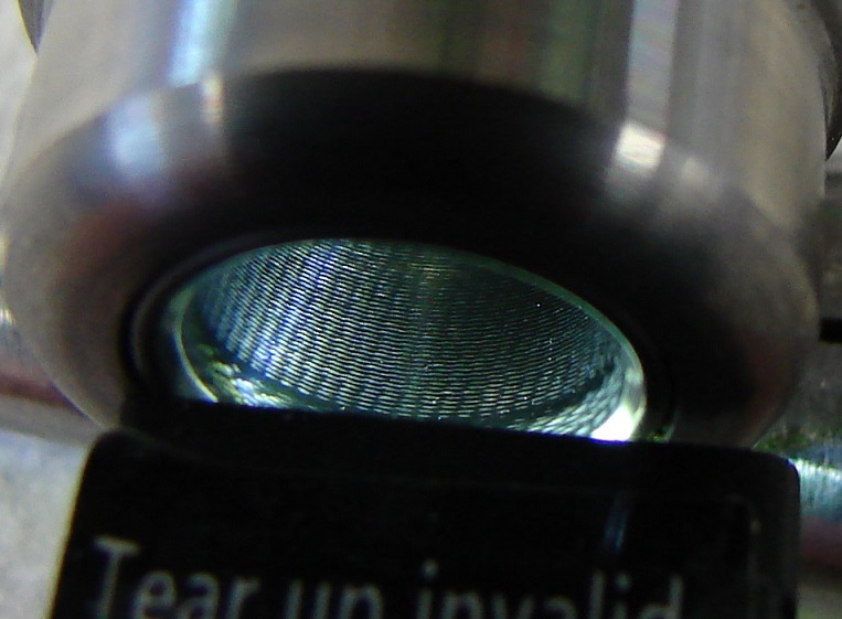

                      Could be that Lee products are like a box of chocolates, you never know what you're going to get. Here's a FCD that I keep for the non-believers. I picked this one up several years ago and it was one of the first ones I had a problem with. Check out the beautiful finish on the carbide sizing ring. Lee Precision it is not. I've got bastard files that are less rough.
                      This die not only swaged .356" coated bullets, it also got tight with a .355" jacked bullet. It'll do a number on your brass too. First time ever I had to call Lee and they were easy to deal with and stand by their products, except they won't pay for shipping, you do. F-that, I just took it back to the shop where I bought it and they gave me another one and told me to keep this one.

                        Looks like that ring has a mirror finish. The rest of the die looks pretty ruff.
                          Damn! Looks like you got the exception, not the rule. After seeing that, I checked my Lee FCD's. None looked like that. Stuff happens I suppose. Still have no issues using them. In fact, just finished 100 rounds of .45 acp. Things working as they should.

                            Here is the one I just got

                              After looking at these last two pics of Lee FCD's, I had to look at mine again.
                              The carbide sizer ring on my .38/.357, .45 acp and .45 Colt look to be larger, in other words, about a 1/4", where as , what I can see in those pics is maybe, an 1/8"? And no tooling marks like I see on yours. Very smooth. Perhaps the older dies are indeed more precise. Don't know; just what I see.
                              MLC
                              • #30
                                vdubber
                                • 369
                                Womder if i Flitz (non abbrasive polish) what will happen
