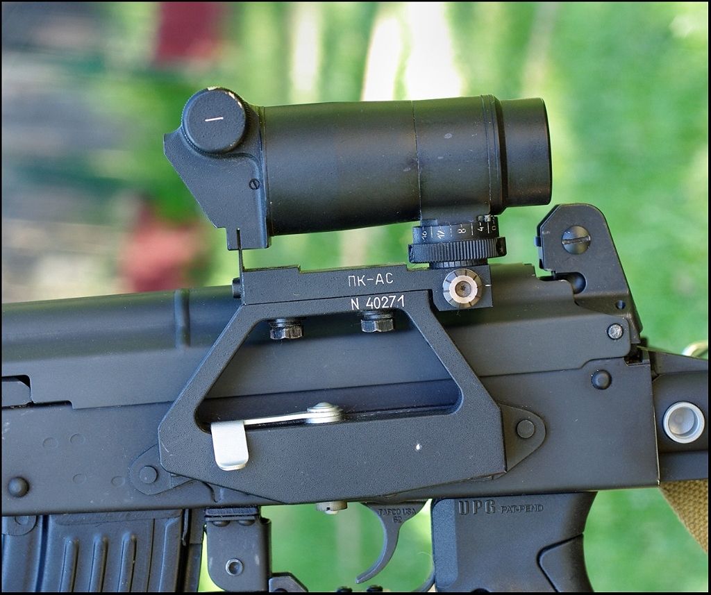

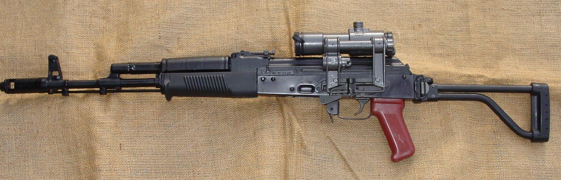

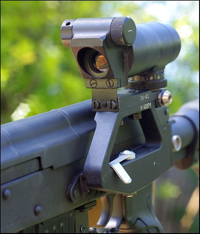

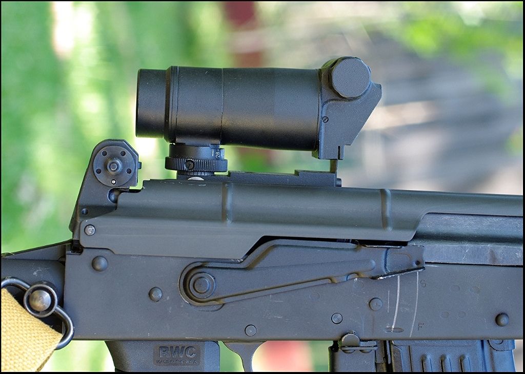

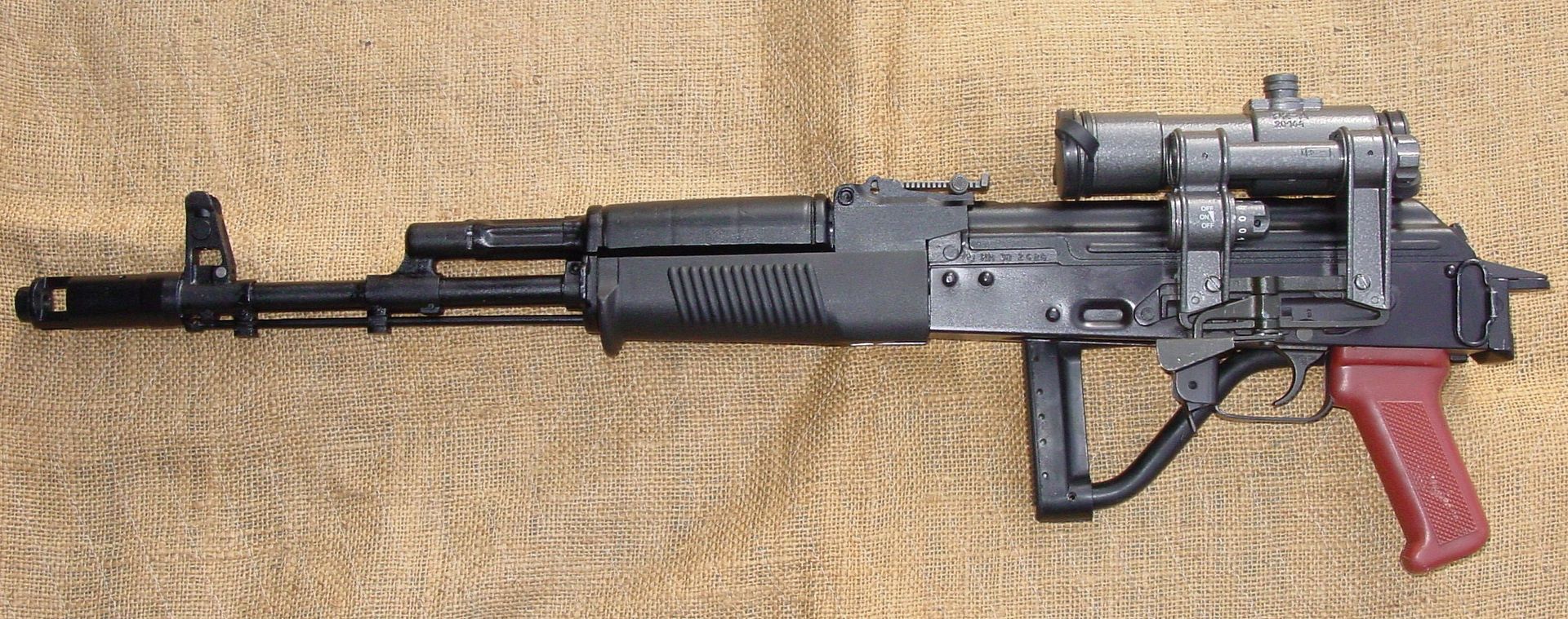

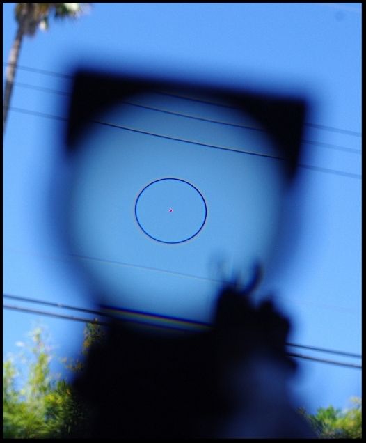

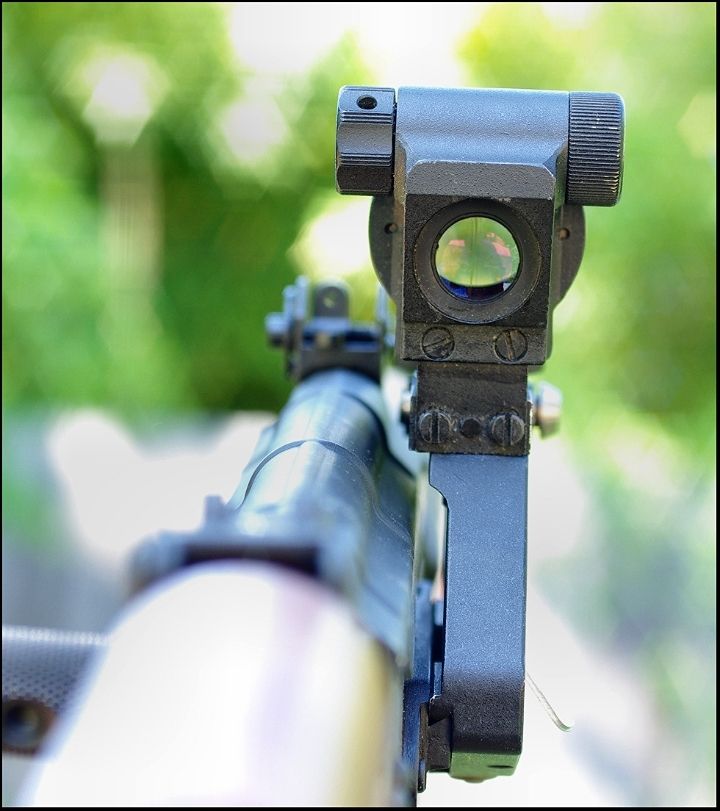

                      PK-AS
                      Probably one of the oldest red dot/AK sight after Kobra. Very unique sight as it sits completely to the left side although there's a model that sits over the receiver but with much higher cheek (or chin) weld.
                      It is powered by a battery but it's not required so it can be used without battery during daylight.
                      Very small/compact sight.

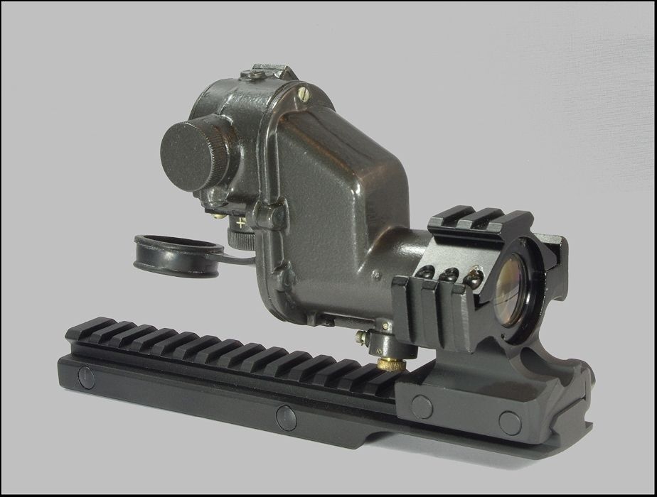

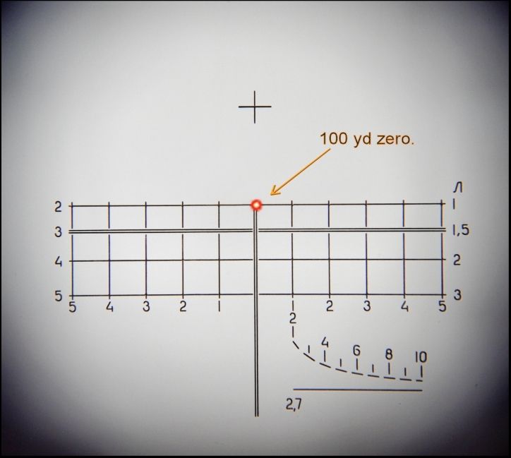

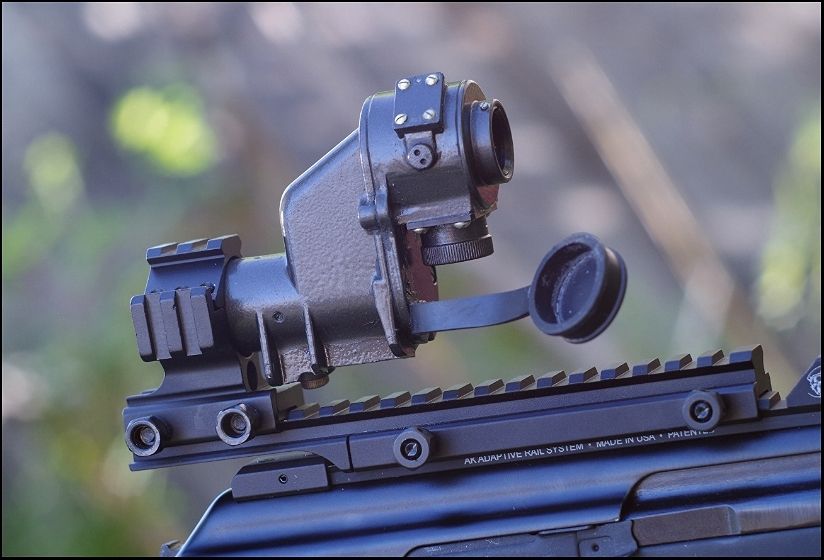

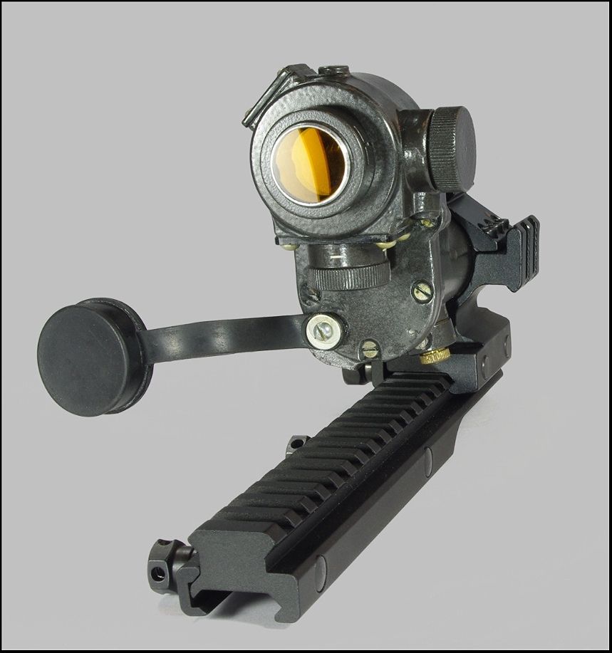

                          RPG-7 scope.
                          Cut off the original QD mount, install 32mm on the rear tube. Rock solid mount. 32mm Ring is attached to rail that can be mounted to any rifle.
                          Lowered reticle and laser zeroed at 100yd. Eye relief is somewhat close but not that a big deal with mounting it a bit rearwards.
                          I believe this is 2.8x, very clear glass. Comes with several filters, yellow is in the first photo.
                          Very neat and cool scope.

                            Oh good. I'm not the only one who thought of adapting a RPG optic

                              You can use them as is......but I don't like getting so close to it (eye relief), basically changing stock/neck position to unusual and uncomfortable position.
                              This way it's much better. The key is to fabricate one that it sits over the bore or further back than original.
                              Mine came out like I wanted it, but there's another more professorial way I could have done it (involves AD 32mm mount).
