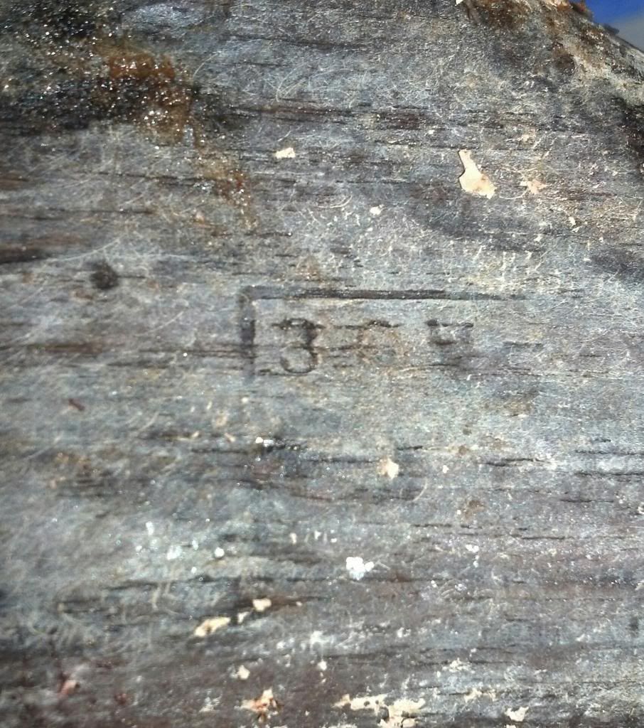

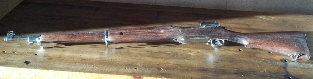

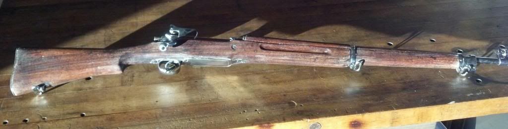

            Here is M1917 after removing the paint.
            On a side note, let the pain stripper sit for a while (30-45 mins) before removing. This seemed to really help the process.

                    For use as parade rifles. I'm guessing "parade" means working rifle as opposed to "drill" which means chunk of welded metal.

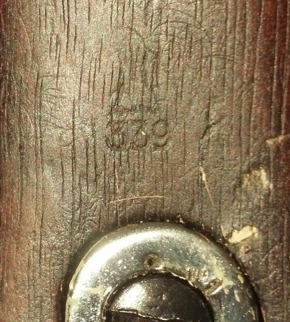

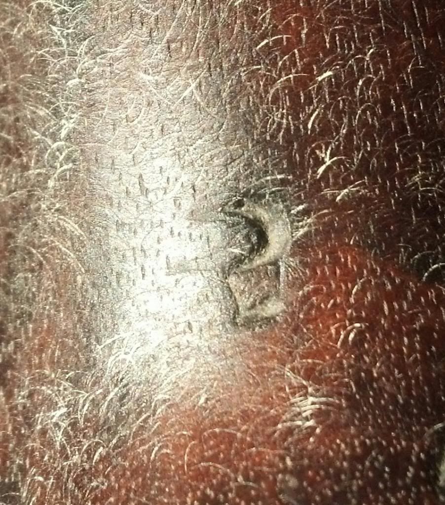

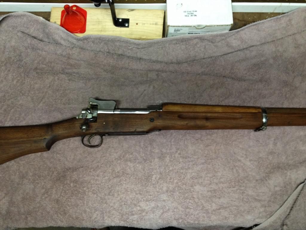

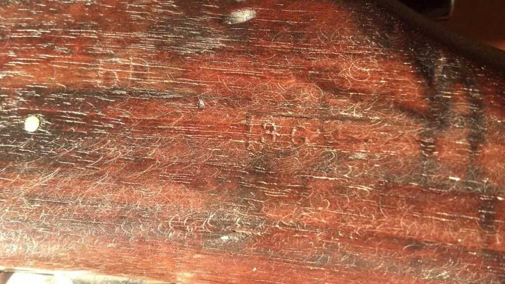

                    Thanks for the advice guys, she cleaned up nice. If you look close, you can make out two different eagle head acceptance stamps, the serif proof P, and some WWII rebuild stamps.
