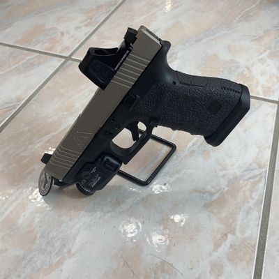

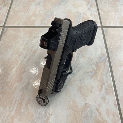

                      The Suarez slide with a HS407C and a CA magwell doesn't look bad at all...
                      Just waiting for the Loctite to cure, then it is to the range tomorrow for slide break-in and optic zeroing...
                      Originally posted by rodralig
                      Quick update - the slide from Suarez had arrived. It is partially stripped - I only added the option for "black front/rear sights," but no internals. Although I have OEM spares, I ordered a slide parts kit from Brownells for around $50 (Suarez are charging $150 extra).
                      That said - the slide doesn't seem to be new... Or if it is new, quality is not as par as I expected. There were a few blemishes on the slide (silver/gray color) and a small scratch (crack? dent?) on top of one of the rear serrations.
                      To be clear, these are just cosmetics, with the pistol eventually becoming such with use - I don't really mind. But, just a bit "hhhmmm" for something new...

                        Dang you, A.....nice set up
                        Now you got me thinking of either milling my G34.3 or getting an aftermarket slide with an optic cut for it......OR take TomT’s advice and get another MOS
                        I love my G19.5 MOS.....I have 3 handguns with red dots....would only be right to do the G34.

                          Hahaha!!!
                          Thank you... Thank you... I think it did come out good - I didn't want to mill the OEM slide, so opted for a pre-cut one.
                          The good thing with the pricier $$$ Suarez slide is that it has tighter tolerances than stock. You could definitely feel the fit. It feels a bit heavier, too. Could it be the OEM 4140 slide compared to a 17-4? That, with a direct mount - no need to worry about the MOS plates/screws failing.
                          Definitely the magwell for the Wife - so it helps with her reloads (I, personally, don't need a magwell). Then the optic - I originally intended to use my 3.25MOA RMR06, but felt, that the HS407C 8.0MOA circle would be more suited to her use cases (10-yards and in).
                          Except for the guide rod assembly which is an ISMI with 15# - internals are stock OEM, albeit, the trigger assembly are polished (no change in geometry). A TLR7 WML completes the setup.
                          That said, I think I got bitten by the Carry Optic bug - I had the polymer Q5 with a Leupold DPP for at least year. Never really got into it; now the 5.0MOA SRO on my match G34 MOS Gen 5, and with a leftover RMR06 (which will be going to the home defense G21SF).
                          One thing though - depending on how the break-in proceeds and how the Suarez performs - I may replace my G34 MOS Gen 5 with a Gen 3 frame and a Suarez slide... I hope that I don't regret getting the G34.5 MOS, though (albeit at pre-COVID cost). You definitely need to setup your G34 with an RDS, as well!

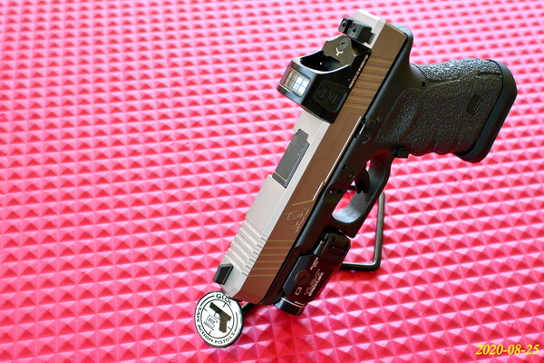

                          I took another photo this morning (unfortunately, am not really a photographer, so...)

                              It looks Great! Very clean lines and subtle.
