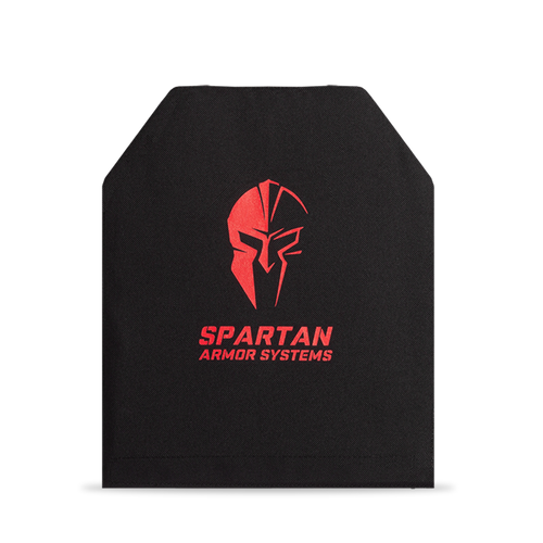

        Originally posted by sirgrumps
        Any recommendation for spall guards?
        The ones I have I think are from the old Main Guns and Cati Armor... typical plate shaped flat nylon container with the Aramid fiber sheets inside... I think they are all over Amazon and Ebay and there are pretty fancy looking ones that look good.
        Do the research, but...
        Spartan Armor Systems® Spall Containment Sleeves add an extra layer of protection when wearing AR500 or AR550 Steel Core body Armor Plates. Designed to provide additional fragmentation (spall) mitigation to limit injuries when shot.
        Shop Now! Never have to worry about spall with our spall liners for your plates. Designed to be used in conjunction with steel body armor plates for superior protection from spalling or place it behind your armor to work as a trauma pad. Made in the USA 🇺🇸
