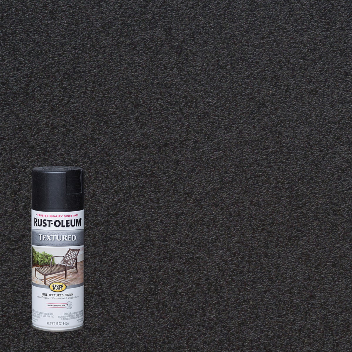

    Exposed metal would be from where they pinned and welded it.
    You can blue it but the correct way is to parkerize it.
    If you don't want to spend the money for parkerizing and moly resin you can always just used Rustoleum Textured Black spray paint. It very closely matches the original Saiga finish.
