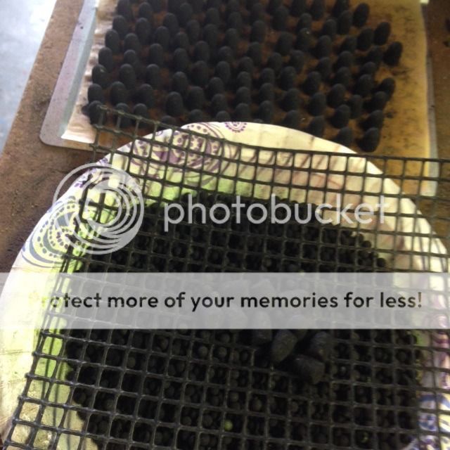

                      Originally posted by stilly
                      That is not a bad Idea but the liquid like properties of the powder and how easy it is to dust it says that that method could be messy. BUT I imagine that you have enough powder on them already? Pour them onto a surface and just pick em out.
                      I purchased locking hemostats one 10" and one 4" I think and I have been using them to pick out the boolits and place them on the foil.
                      If I could just dump them onto the foila nd tilt and roll away the balls, that would be cool, but then I would have a lot of powder being dumped too and I am not thrilled with how the boolits roll around. Maybe rifle is easier to do.
                      biker: YEah you can do .30 cal and .224 and all that but we just happen to do more pistol boolits. I shoot my .45 in an indoor range and I do not yet load for my ARF so for me it is only pistol boolits now.
                      Also, why do you have to recoat so many times? I have seen the PC fluid beds for fishing jigs, they are CRAZY cool and you can make your own, they do an excellent job of coverage I thought.

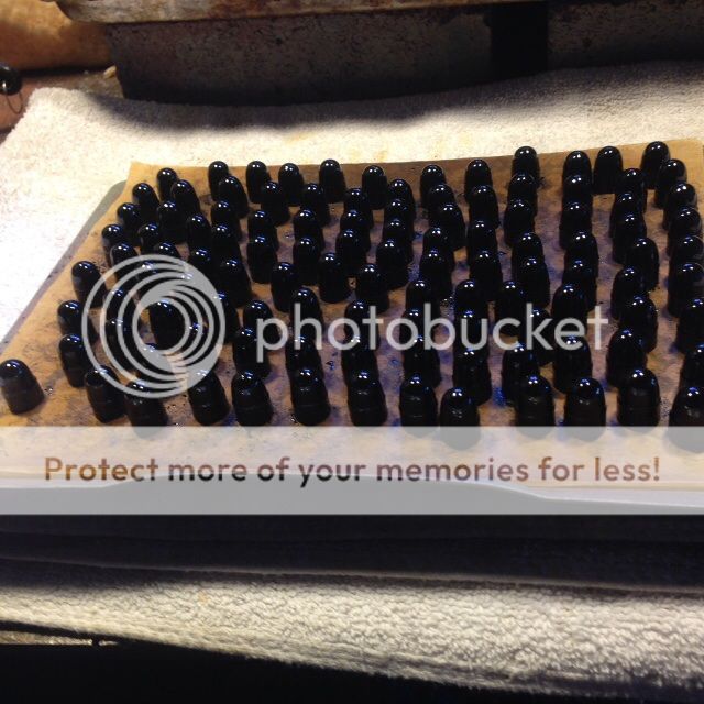

                      Well I tried pouring them through a mesh today. Using a plastic mesh. With a paper plate underneath.
                      Though I did get some scuff marks.
                      I'm thinking of making something to raise the mesh a little more.
                      Thanks to the gloss black, it flows better then most colors. The scuff marks went away during cooking.
                      It took me less the 8 minuets to pick and stand these.
                      With a little more thought, I'm hoping to get the time involved down closer to tumble lube.
                      Maybe some type of ammo tray with the bottom cut out to set the bullets upright?
                      Ideas?
