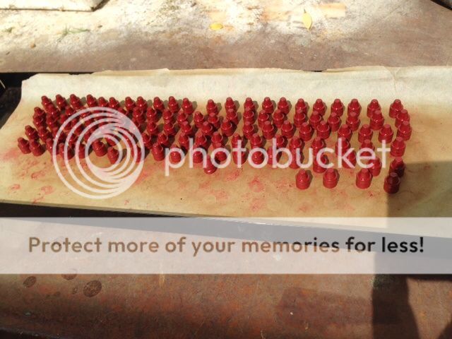

    I thought if I use a steel plate over my BBQ grill it would help regulate the heat.

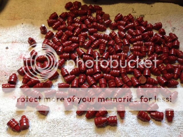

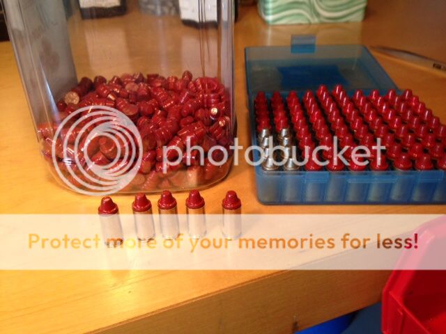

    I'll be damed it worked. 12.00 powder coated bullets with good smooth coverage.

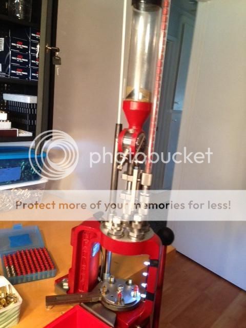

    The bullets even match my press and now my bullet feeder works great.

    Is that parchment paper lining the inside of the metal tray? I thought you wanted the heat to reach 400F. That doesn't leave too much margin between "just enough heat" and "paper catching fire".

        Yes it's parchment paper. And I used the same piece for 6 bakes.
        No sticking at all.
