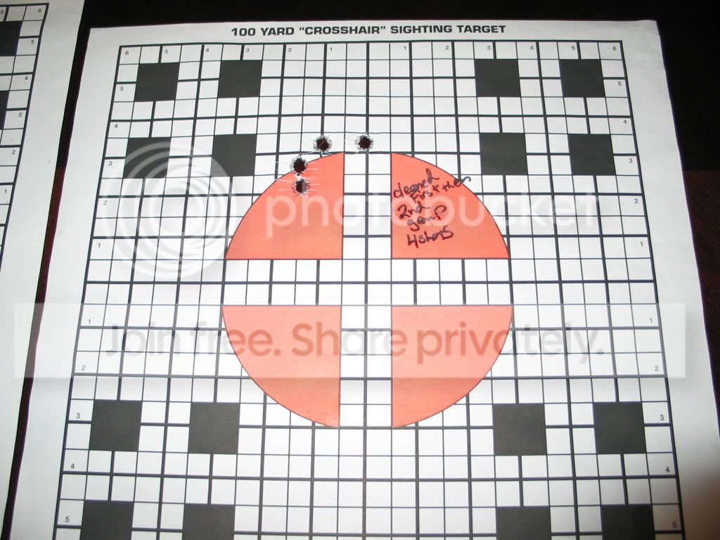

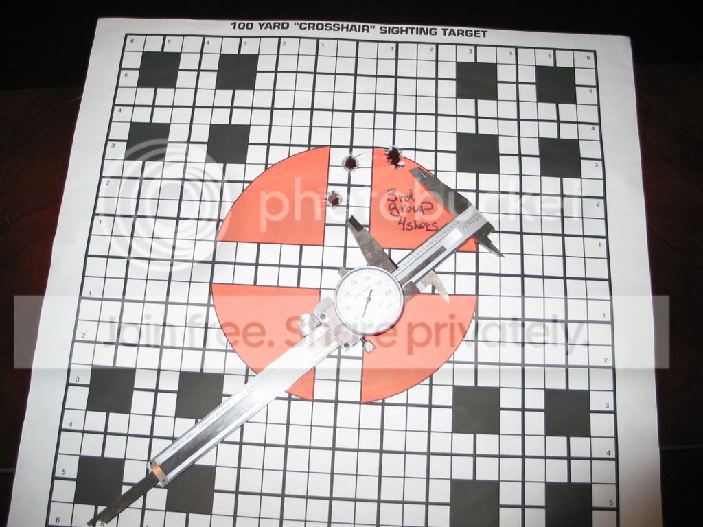

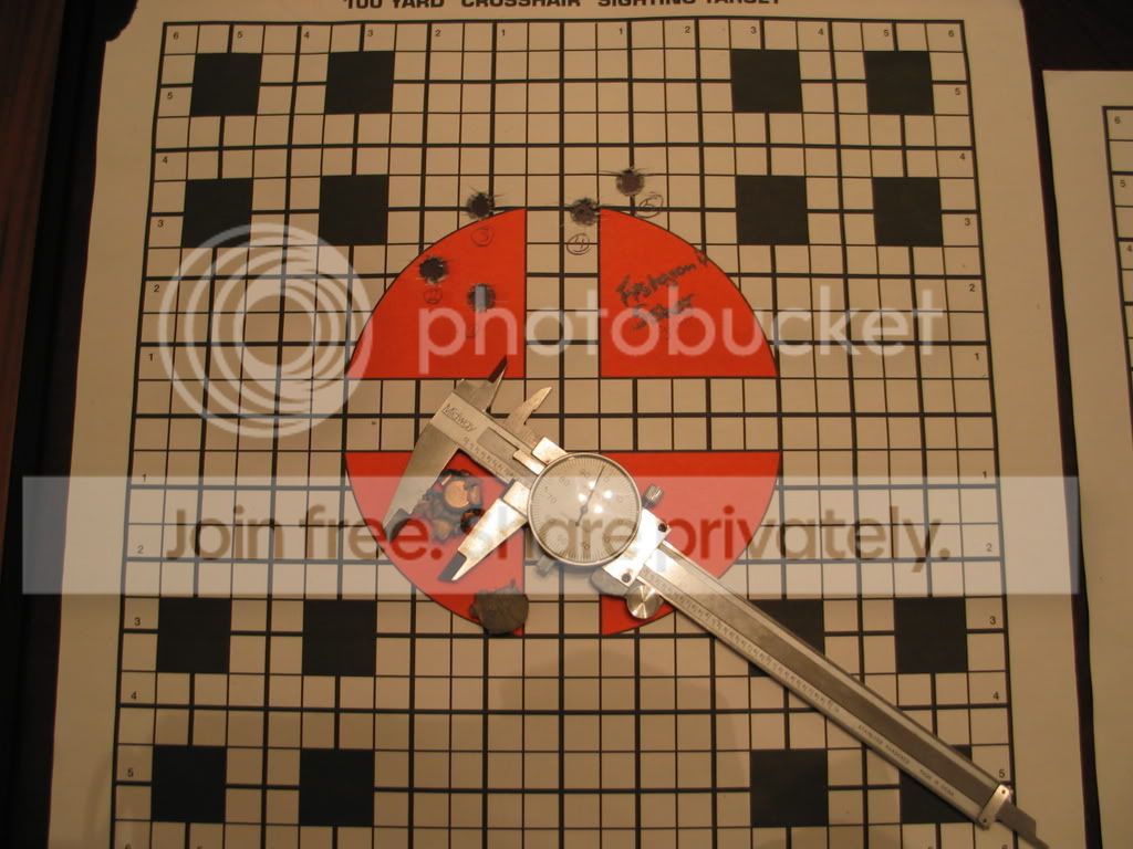

                    Friday was my first range day with my 450, as you can see from the group pictures it was a good day. I was only able to shoot a little because of time restraints put on me by the range officers. They left 45 min early on Friday.
                    Light breeze from my back
                    88F
                    All of the above targets at 100 yds.
                    After 2 shots at 50yds to get sighted in I moved a new target to 100yds and made the first group. I did not clean the barrel for the first string and after firing the first string I noticed that the spent casings were oily so I cleaned the barrel.
                    The second target the group tightened up, but was slightly to the left, so I moved my scope for the last time.
                    The last target was just what I was looking for, two inches high at 100 yds and 1 3/4 in group. It looks like 3 holes but it is four.
                    I was able to recover 2 of the slugs you can see them in the first picture.
                    I recovered them from the berm at 150yds it was hard packed and dry.
                    the largest slug retained 219.9gr the smaller slug retained 207.4gr.
                    The two slugs were an average of .8 in, but at the longest point of the larger one was 1in.
                    The scope was a Nikon Pro Staff 3*9 BDC.
                    I used the magazine that came with the rifle and it fed flawlessly.
                    All rounds were factory ammo.
