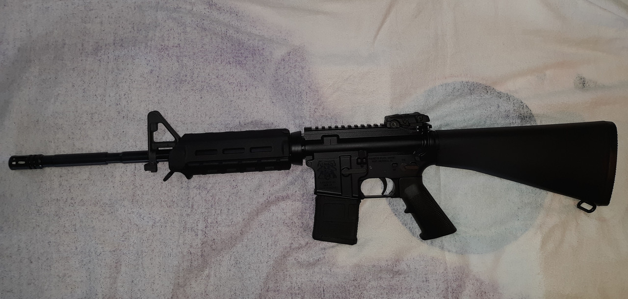

        got my upper in and finished the build - turned out pretty good, now i just need to get out and take it for a test drive
        im thinking i want to add a carry handle - prices ranges i've seen are all over the place but i do want a good one
        maybe someone who has done some builds can recommended me a good handle and a price range i can expect to pay

          Looks good. You will want to function check the safety and trigger
          If you have dummy rounds you can function check with those to be sure the rounds are feeding manually and that the bolt hold open works.

              Looks good. I don't know what you have under the stock but you have a carbine barrel matched with what appears to be a rifle buffer, spring, and buffer tube. You might have a mis-match there. If so, you might experience some mis-feeds and ejection problems. You are going to need a carbine buffer, spring, and buffer tube.
              And as far as the carry handle goes, if you want a carry handle, get yourself an A2 upper. I never understood the appeal of the bolt-on carry handles. But, to each, their own.
                you may have a great point there, and no, i never verified the compatibility of the buffer, spring, and tube that came with my stock
                worst case, i need to buy the proper buffer, spring, tube for that carbine, easy enough i hope
                as far as the handle, i would love to have an A2 upper, i see them for sale but couldn't find one complete that i like - maybe for next build i'll look harder because i agree with you, i really don't like the bolt-on but for this build that ship has sailed
                anyway, thanks for the heads up on the stock, i'll look into it

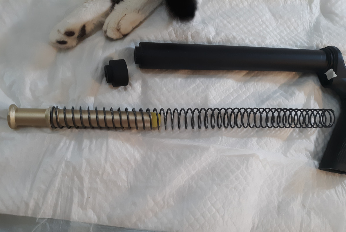

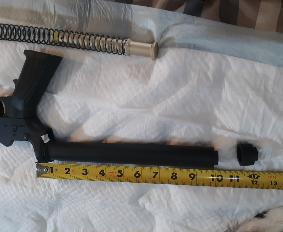

                        Ok, so I got curious and there's no time like the present. The carbine buffer tube measures about 7 1/4". The rifle buffer tube measure measures about 10". Ok, since we are on the subject, both A1 and A2 rifles use the same length buffer tube. The A2 has a spacer installed at the end of the buffer tube to accommodate the longer A2 stock.
                        So you would need a carbine spring and buffer. And to use the rifle stock, I'm guessing somebody sells an adapter. Maybe a spacer that goes inside the rifle buffer tube for the carbine spring to sit on. You could probably make one out of PVC or a wood dowel but you would have to know its length. I'm guessing 2 3/4" for starters.

                          disassembled the stock from the lower - here's what it looks like size wise - don't mind my cats feet, i was using her area and she didn't like it so she bogarted into her spot

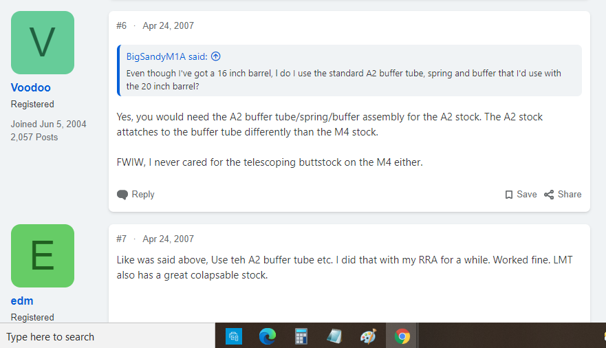

                          i also found this bit of information on a site that was having this very discussion about using an A2 stock on a carbine - does it make any sense?

                              found a discussion about this, and a few photos at this site: https://www.ar15.com/forums/ar-15/A2...rs/118-560003/
                              wish there was more discussion about the stock compatibilities when using with a carbine, i.e buffers, springs, tubes, or adjustments made for the best performance
