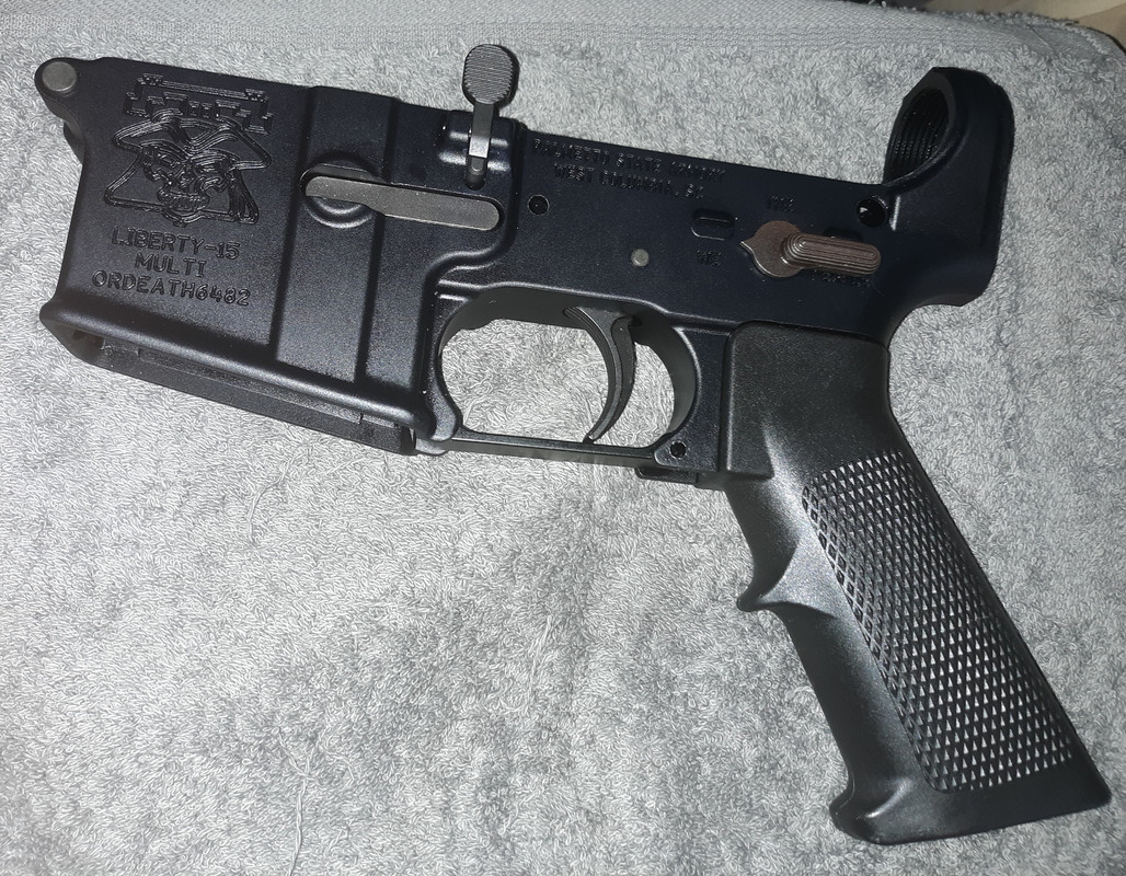

    it got real today - placed my order for the stripped lower, parts kit, and my stock
    here's what i went with for my first build - hopefully more to come
    i WAS going to go ahead and order an upper receiver too, but i decided to finish the build then take some time to see more of what's out there
    i do like this one though, i have it saved
    thoughts?

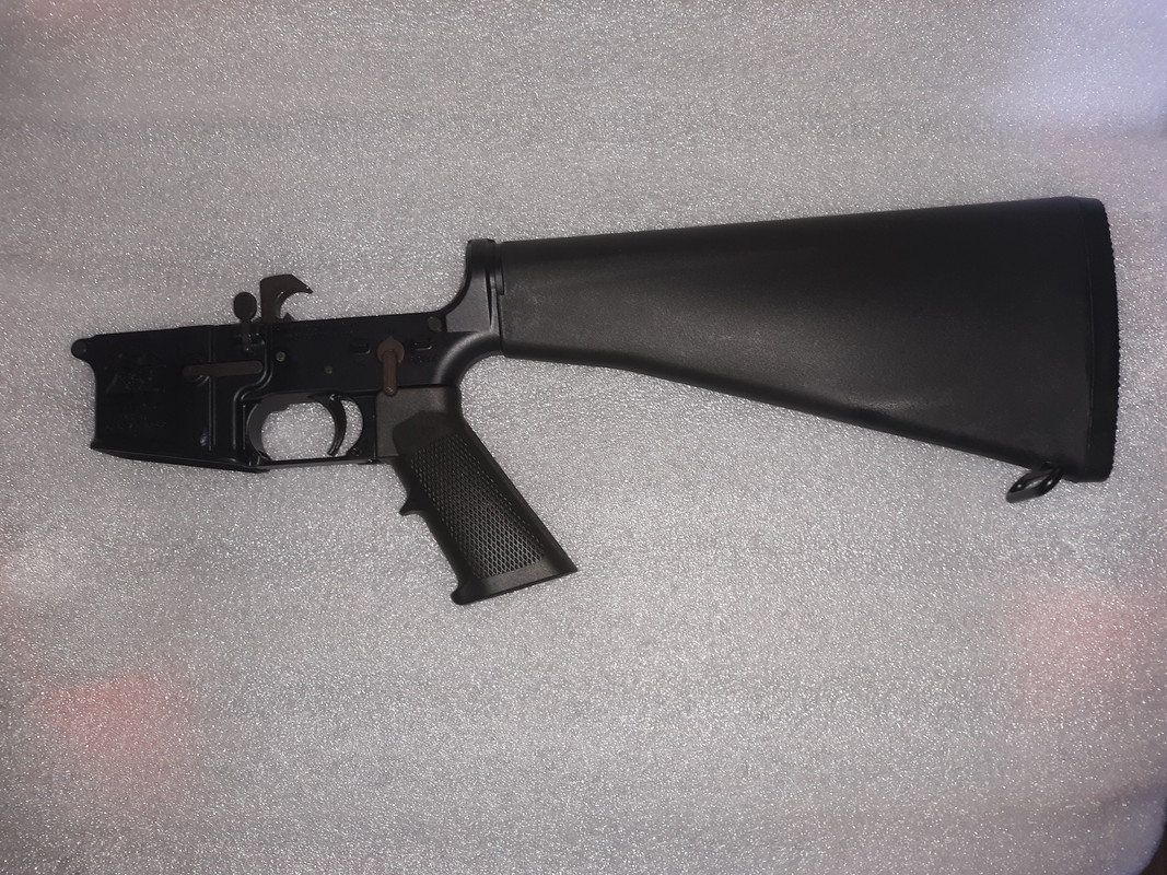

                    So, how is the build coming along you ask??
                    well gentlemen, there is good news and not so good news about my first build - picked up my lower from the FFL this afternoon, brought it home and decided to get right at it after dinner
                    first impression - TOO EASY
                    started off assembling the mag release, took a couple of minutes to get that out of the way
                    moved on to the pivot pin and got that done in about a minute - so far no springs a flying
                    THEN IT HAPPENED - sigh

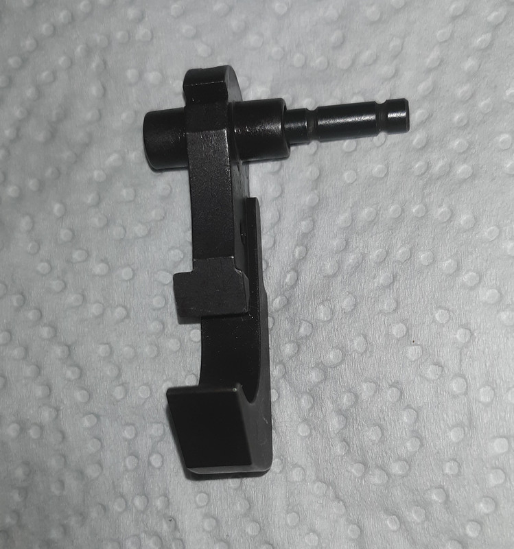

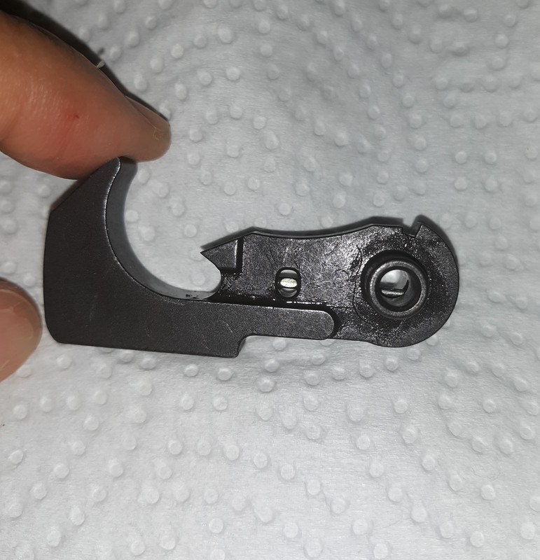

                    moved on to the trigger and hammer - started off putting on the trigger spring, then the hammer spring - slipped the trigger and disconnector w/spring into the receiver slot and secured it easily with a retaining pin
                    the hammer proved to be my Achilles heel - but, i don't think it is my fault
                    i correctly placed the hammer spring over the trigger and pushed it into lining up where it's retaining pin is inserted - only problem was, the retaining pin would not push through, no matter how hard i tried - i would line it up perfectly only the retaining pin would not go through the hammer opening, even using some slight tapping it wouldn't budge
                    i removed the hammer and decided to do some investigating - sure enough it didn't take long to see the problem - there is a spring inside the hammer retaining hole that is supposed to catch one of the slots of the retaining pin to help keep it in place - only this spring won't allow my pin to get through and im afraid that if i force it thru then getting it out in the future might be even more difficult
                    im thinking it protrudes too much into the opening and won't allow the pin to continue through
                    here's a picture of the inside, you can see the spring and even though i gave it a few strong taps, NOTHING, it will not get past that point where the spring is
                    even after i removed the hammer from the receiver i still could not get the retaining pin to tap through the other side of the hammer - this is as far as it would go
                    being a first time build obviously i did not try to HULK it in, thought it might be better to come in here and post the issue and hope someone here could offer a way to resolve the problem - from what i can see in other "how to" videos this type of hang up does not exist, the pin, once lined up generally pushes right through to the other side easily enough
                    hopefully someone here knows something i can do short of returning the hammer for an exchange to get that pin pushed through
                    anyway, i moved on to the rest of the build and finished getting in the bolt catch, the selector and the grip assembly - all that is really left besides the hammer is the stock along with the takedown pin
                    so far here's what i got
                    edit** - i know i could probably take a small flat head and bend that spring a bit back at it's origin just not sure if i should

                      In short, a 'stout' J-spring is a good thing. A 'bad' or 'defective' hammer and/or pin is possible, but unusual. Oil and, sometimes, a wiggle can be your friend.
                      Sheer, brute force should not be required. Think... firm but loving.
                      It's not an unusual 'hang up.'

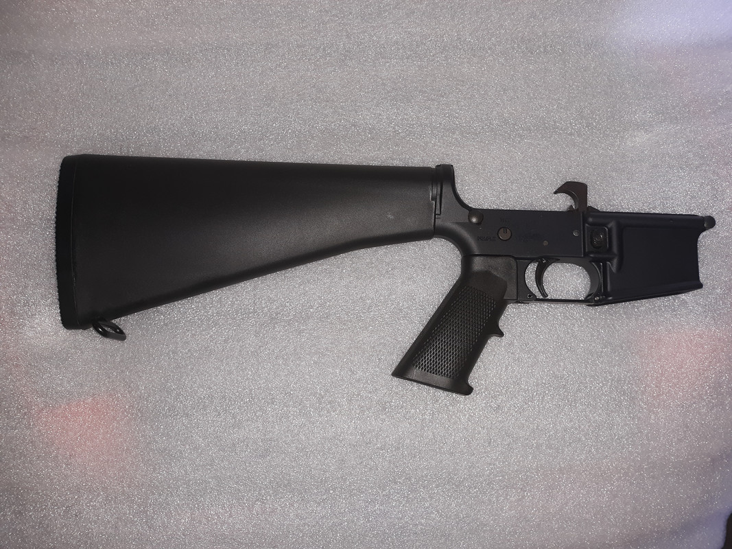

                            blah
                            i went ahead and got that damn retaining pin into the hammer hold
                            that said, i finished the build, everything seems to be functioning fine and i'll have the upper in first of next week
                            i think it's gonna look pretty good - here's how the build finished up
                            this is the upper coming in: https://palmettostatearmory.com/psa-...us-bcg-ch.html
                            hopefully build #2 has less drama

                              I put together 4 AR's over the years. My 1st one was long before the internet and with no instructions. Just a bag of parts that I pieced together like a jigsaw puzzle. I scoffed at some of you guys who posted that the detent pin for the front take down pin was difficult. I don't remember ever having trouble with that in any of my previous builds and I don't remember ever using any special tools.
                              I sure was humbled this time while putting together my AR9 lower recently and I apologize. That little sucker required a few 4 letter words. I shot that pin across the room twice. Luckily, I had it pointed at a wooden cabinet so when it hit, I knew about where it was and was able to find it with a magnet. The 3rd time, I put a cardboard box in front of me. It hit the box and bounced off the table but was able to find it with the magnet.
                              I ended up using the clevis pin from my upper vice block, using the cotter pin hole as a guide. I then used the cotter pin to shove the detent in and rotated the clevis pin once the detent cleared. This took me way too long but I was able to put the rest of my lower together within minutes.

                                Glad to see you got it together. Now you are a pro. I've had the same issue with the J-spring in the past. I just used a punch inserted in the opposite side and pushed the J-spring in and then pushed the pivot pin through against the punch.
