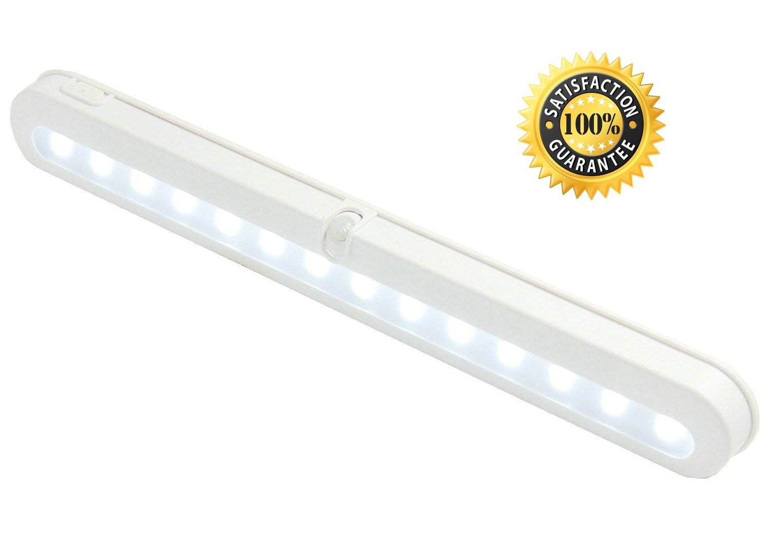

    I put these in my safes. Motion activated. enough light to see what's what. runs on AAA.
    Installation takes 6 seconds.

      I was thinking of it as well but I have personal dislike of replacing battery (that's just me though). Nothing against the usage itself. And I something a little fancy in my "man cave"

                            I use these for $15 (when on sale) at Sam's Club.
                            It's great because you can change the colors depending on your preference - like red to maintain your night vision.
                            I also like that it doesn't come on automatically. You never know when you might not want the lights to come on.
