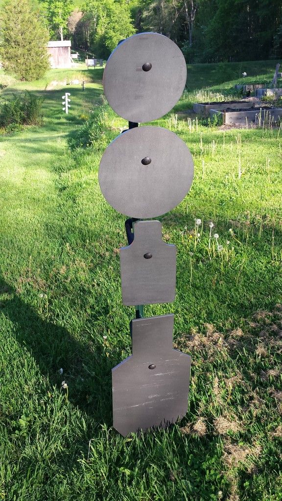

Nice setup op, here's an alternative (not trying to thread jack) I used shallow strut. I work for an electrical distributor so material was free for me (scrap pieces). I just use 4hole strut 90's and 45's with appropriate hardware 1/2" nuts and bolts for the big target stand. Cool thing is that it's modular, I can add on to it if I wanted to hang more steel, also I can break it down with just a 1/2" socket and ratchet wrench. For the little target stands I cut the bottom at an angle so I can drive it into the ground. Stands held up well even being shot at. Got a few holes through the little stands but they'll be okay for now. Just very sharp on the exit hole.

Attached is a plate that was just painted. On the upper right and towards the middle you can see little dimples. They are made from ZQI 7.62x51. 223 and 7.62x39 do not leave any dents on this plate.
This plate is 12" diameter, 1/2" thick, AR500 steel.
Also updated first post for mounting hardware.Attached FilesVisit www.npfreedom.com for discounted firearm parts and accessoriesComment
