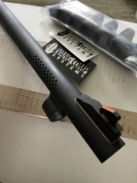

                              Update with my Vangcomp turn around time. Please keep in mind that this is just for the Vangcomp Porting job only, nothing else.
                              02/08/24 - shipped barrel to vangcomp (dropped off to UPS)
                              02/09/24 - barrel delivered to Vangcomp
                              02/12/24 - order updated with notes that barrel has been received.
                              02/29/24 - Notifcation from UPS of incoming shipment from Vangcomp.
                              Later that evening an order update from Vangcomp of Barrel port job completed and shipped via UPS.
                              03/01/24 - Package delivered notification at my property and it was from Vangcomp. My ported barrel "only" and the VangComp detachable side shell carrier kit.
                              Total turnaround time was under 30 days from their estimated 30-60 days.
                              Now to get my 590a1 cerakoted.
