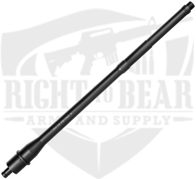

                      This RTB 16 inch .22 LR Pencil barrel is great for easy conversion to a dedicated .22LR setup and works with CMMG or Right To Bear .22LR components. This is the only 22LR lightweight barrel available at a reasonable price. Shop with Right To Bear today and save big!

                        I built my AR-22 upper with a $99 CMMG made barrel from RTB, a $39 Anderson lightweight upper receiver and I used an old Ceiner BCG with a CMMG head installed. The entire thing was under $200.
