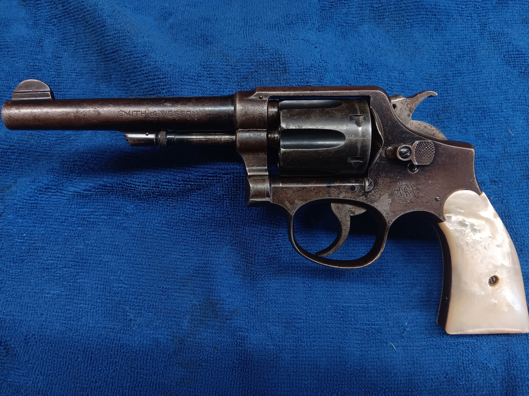

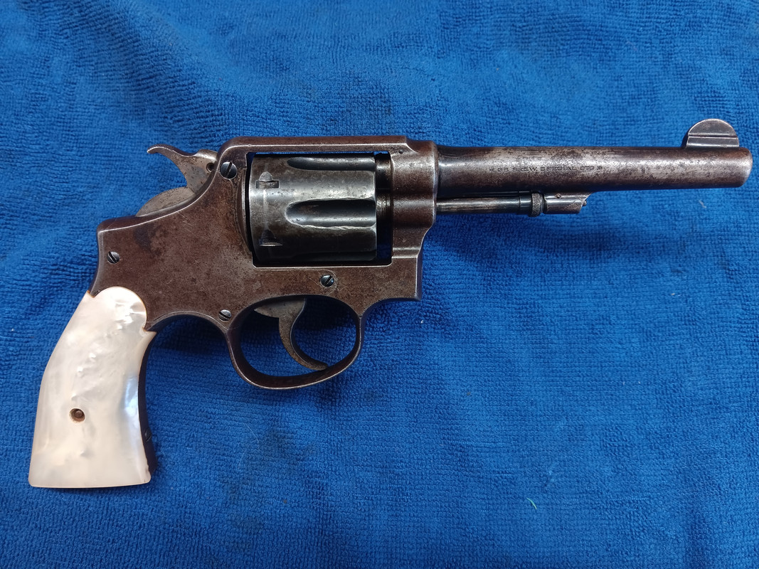

    The exterior is rough but mostly just discolored with some pitting here and there. The bore was dirty but cleaned up to be nice and shiny. Under the side plate there was considerable hard dirt/grime as well as some surface rust, bit that cleaned up very nicely.
    The only real issue with it is that it is out of time - the cylinder requires a slight nudge to lock into place. So - the hand will need to be replaced and fitted. If any of you happen to have one laying about in your parts drawer, shoot me a line. Otherwise, it's off to GPC for a replacement.

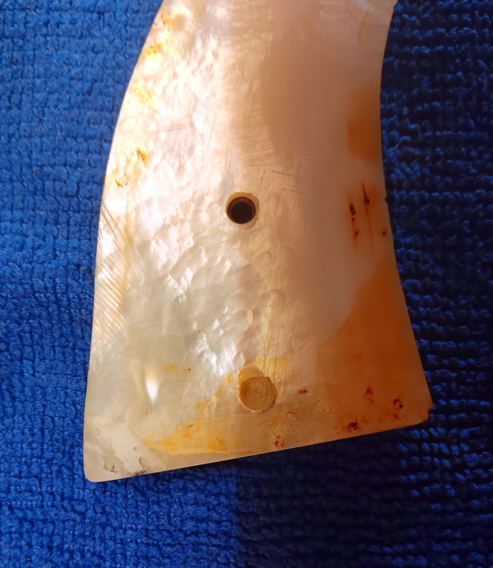

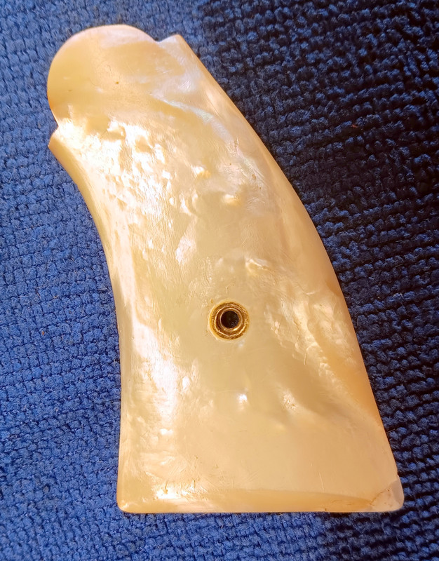

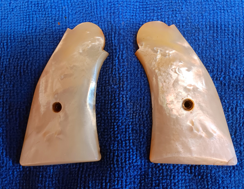

                About the grips - the left grip had the lower rear corner missing, but I was able to fill it in and shape it to an acceptable degree (see pic).

                      Timing is off by just a hair - maybe 1/32 or so. Just requires the slightest nudge to click into place. I ordered a hand from GPC, and I'm hoping they send me a decent one.
