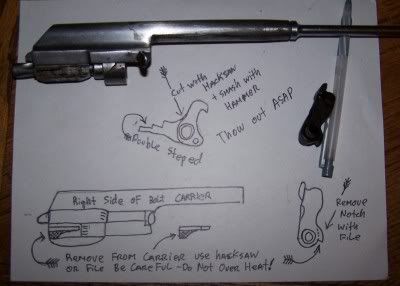

                          I am semi-auto proofing my stuff.
                          When Auto Ordinance was trying to get approval for a semi-auto-only TOMMY GUN carbine, they had to do several designed and expensive approval processes to get approval from BATF. The main "SUGGESTION" from the BATF was that the new design should be - " very hard to convert to FA and need substancial skill and machinery".

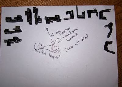

                          I have thown out all un-needed stuff. Its in the land fill. I did not get a double stepped part - but if I did I would cut-smash-dump with in 10minutes.
                          Stuff that left and where to cut stupid part.

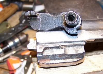

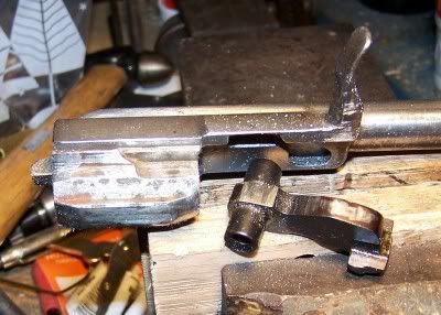

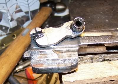

                          Cutting off FA notch on OEM hammer and trip notch on bolt carrier on right side rear.
                          BEFORE parts with notches and hooks.
                          AFTER with notches sawed and filed down.
                          I will not touch or tune my new US disconnector and/or spring. I will make sure the new disconnector has its original finnish. I would only tune the hammer on the trigger sear side and the trigger sear - to avoid legal speculation of intent.
                          A diamond blade hackwas blade saved my AAARSE on this one that bolt carrier was tuff stuff. My goal is to make it very hard to convert to FA and take the precautiond that a REASONABLE PERSON could to protect the PC universe from the EVIL FA. It would not take a lot to get this to FA!!! I will do this to all my fire arms and check purchase's off the rack - so to MORE help to protect my-self.
