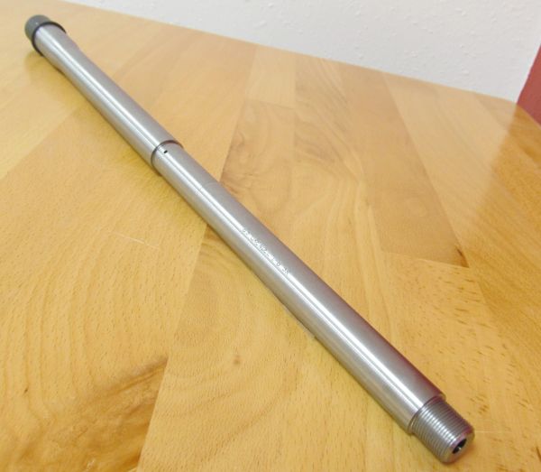

      I personally base all my builds on the barrel. Saving $100-$200 on a barrel is a false economy, as the cost of the barrel is nothing compared to the $$$ spent on ammo you send through it. The barrel is the heart of the rifle, and its the absolute last thing to skimp out on.
      If I were building an upper right now for 6.5 I would use a Liberty or BHW barrel, "standard" mil-spec upper, Fail Zero or similar BC, Alexander Arms bolt, and whatever HG suits your taste (I like the OdinWorks or Seekins lightweight ones myself) and then drop it on your lower.
      Note that the Liberty Barrel comes with a headspaced bolt-
