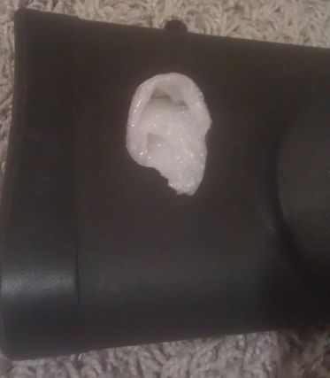

          SPS tacticals are really lacking. I'd just get the SPS Varmint if you want to shoot the factory barrel (the .308 5r is the only model that comes with an acceptable barrel, IMO). The tacticool, just throw away the barrel and put on something decent.
          I have a Remington whiffle bat that I sometimes use as a mallet, well, that cracked. It's so friggin cheap that it has packing foam on the inside. I thought they'd at least have a molded plastic frame, but no, cheap packing foam. I can still use the other side of the mallet until that brakes.
            Can I have that buttstock pad? I cut mine up and would like to replace it lol.
                    Without the butt pad, I don't think I will have enough support for the plastic mallet. But, what the heck--I have actual mallets, it's just the Remington mallet is longer and provides more leverage. Since one side is broken, it's lost half its life and all of its resale value. PM your address and I'll send it to you if you want it.
