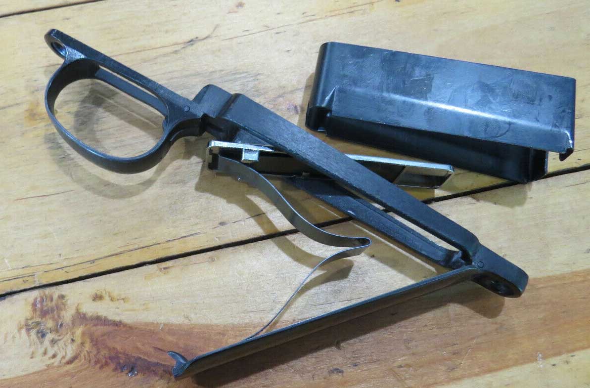

                Can anyone explain this .. I have absolutely no idea here . For same action , I have 2 options for the magazine ?

                  Unless you already own a Remington 700 action, I'd go with a Defiance, Gunwerks, or other quality custom action. In the long run, the custom actions will be cheaper than having a gunsmith true and blueprint the Remington 700 action. The other posts are referring to magazine length and the type of magazine you can use. The first one states that you must use a detachable magazine system from Seekins, and you cannot use a standard BDL magazine for a Remington 700. The second is saying something similar except the action is set up for a Wyatt's magazine which is for loading longer cartridges. What do you plan on chambering this rifle in?
                    ar15barrels
                    • 57126
                    A BDL cut on the underside of the receiver is required if you want to use a BDL magazine box setup.
                    That's the standard 700 system as made by Remington and also Wyatts but Wyatts boxes are longer so hence the longer port in the bottom of the receiver.
                    In the standard setup, the magazine box holds the cartridges but the cartridges actually feed from the lower rails of the receiver.
                    In the Seekins cut, you can NOT use a BDL magazine box so you MUST get an aftermarket bottom metal which has a detachable magazine which will have feed lips.
                    The most common one of those will be the AICS or AW mags.
                    AICS mags are center-feed and AICS magazines will fit into a BDL cut action.
                    AW mags are double stack at the top just like an AR-15 or an UZI and you can NOT use an AW mag in a BDL cut receiver because the BDL feed rails keep the AW mag from fitting up into the action far enough for the bolt to feed a cartridge.
                    The two actions above are NOT the same.
                    One is the "tactical" model which only takes detatchable mags.
                    The other is the "hunter" model which can take an AICS mag OR a Wyatt's extended factory BDL setup.
                    Hunters want lighter guns so they typically use the factory drop floor bottom metal and the Wyatts will allow a longer loaded cartridge length than an AICS mag.
