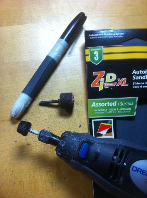

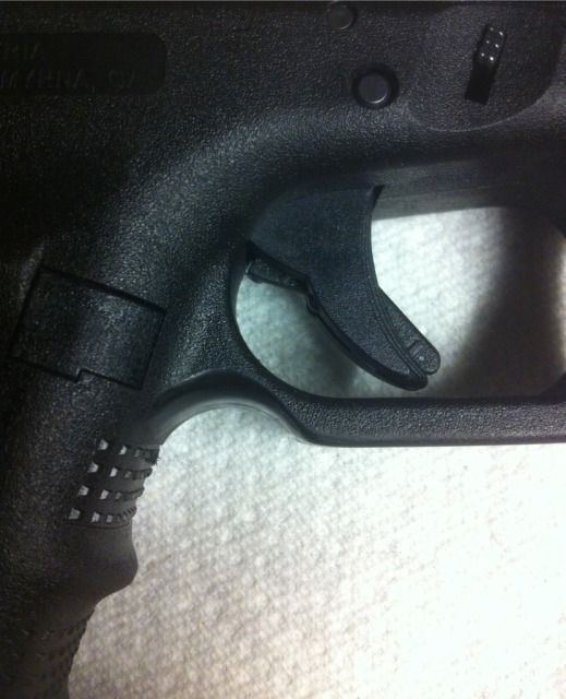

                I just took enough off to keep from getting Glock Knuckle. First I wrapped some 400 grit sand paper around a sharpie. Then Sanded an angled groove into the side of the trigger guard. Once I had a nice groove started, I got a little more aggressive with a dremel & sanding drum. Once I got it how I liked it, I smoothed it out with the dremel & a polishing drum. Be careful with the polishing drum on the polymer. It heats up & melts if you use too much speed or too much time in the same spot. No big deal, it just takes longer to get it smoothed out.

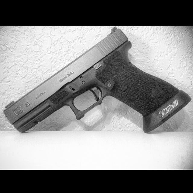

                              SDM44
                              • 3851
                              The top photo is Boresight Solutions, the bottom photo is Tactical Textures & Triggers.
                              SSVI also does the same thing and makes it look clean like that, but I think he's not taking on any new work at this time since he's fulfilling a bid right now for an agency.
