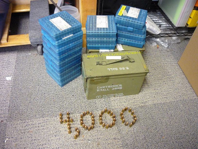

                                My lady just has me do it. Here's the 4k rounds I left her before I deployed
