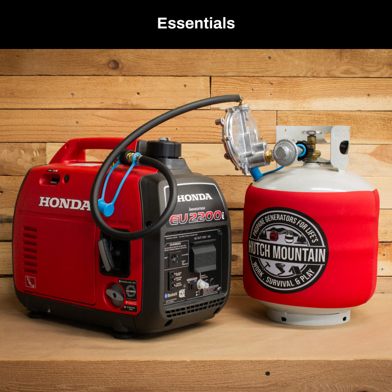

                        Do yourself a favor and convert your generator. Never worry about old gas again.
                        Kit Options Essential Kit: The Essential Kit gives you everything you need to convert and run your little Honda generator on a standard 20/30lb propane tank. Pro Kit: The Pro Kit gives you an additional hose and bracket that allows you to run your Honda generator on natural gas or directly to your RV’s quick connect po
                          https://www.hutchmountain.com/produc...conversion-kit
                          Is the main benefit of switching to propane longevity? I.e. propane never goes bad? I have no more room in my prep area to store anything else, so if I stored propane tanks some of the Jerry cans would have to go. Gas storage serves dual purpose: filling vehicles and running the generator. I?d be open to propane if there is additional benefit other than shelf life
