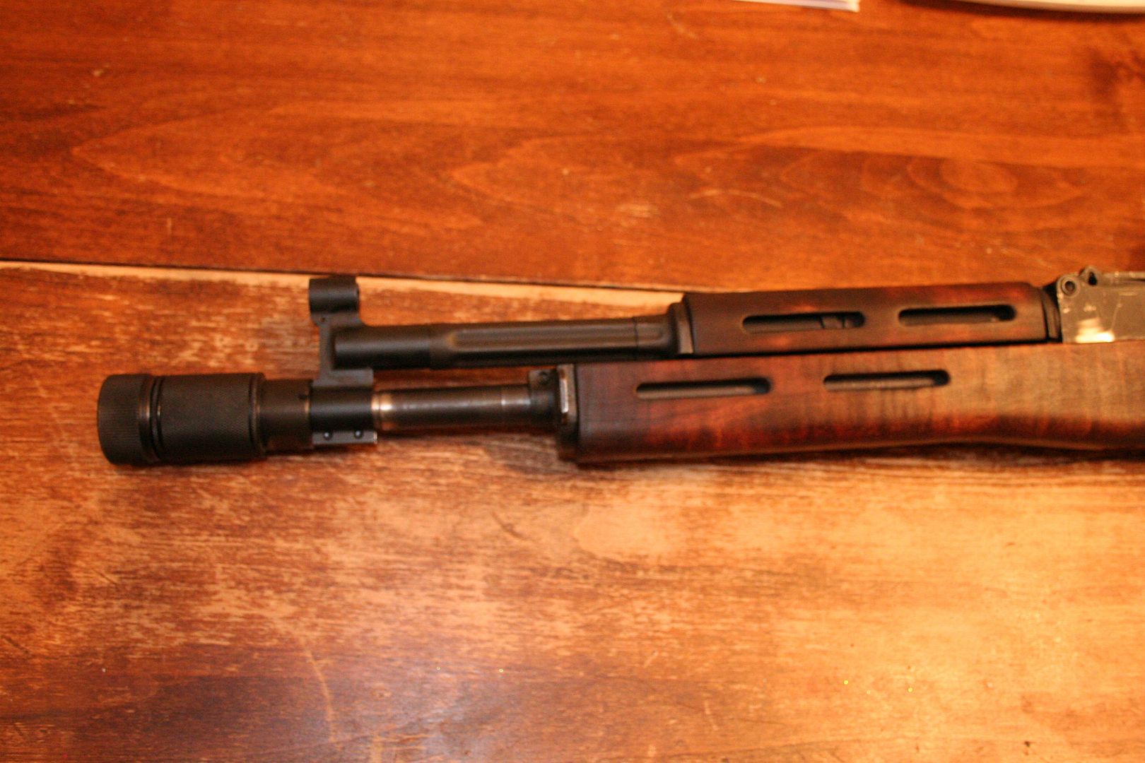

                              Got my fixed gas block back from SJgunguy24 and everything is great now.
                              i finished drilling the set screws last night on the lathe at school and s how she repopulated the barrel this morning.
                              heres how she looks now.
