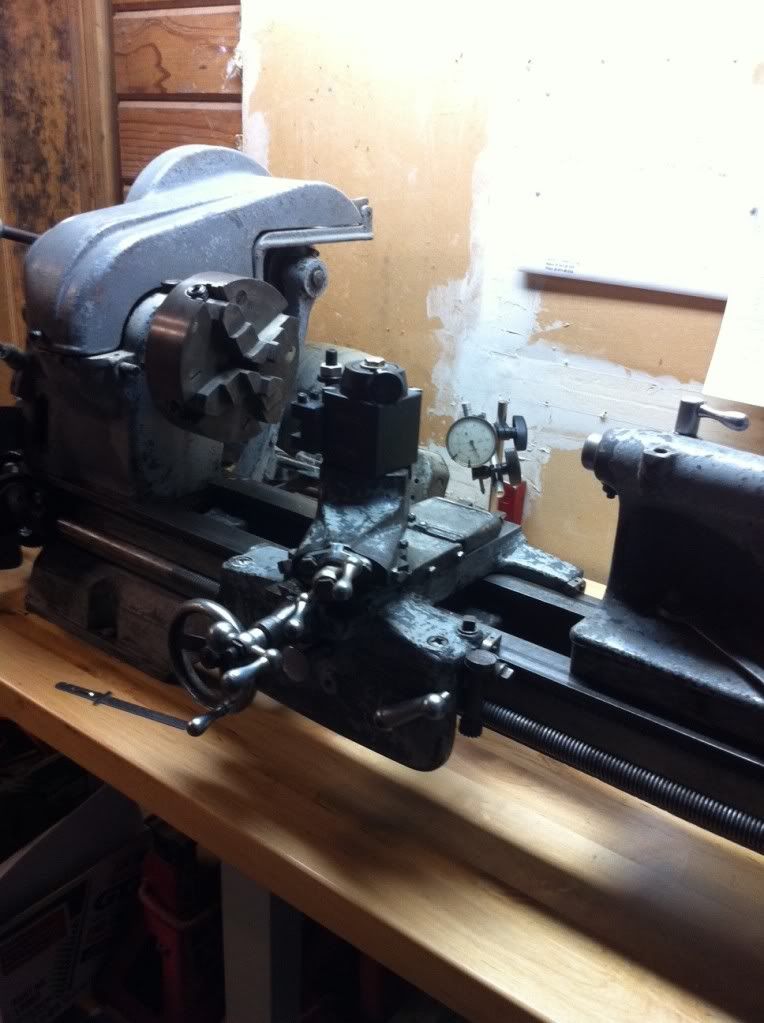

      Very nice! Here is a pic of my 1940's Atlas 12x36. It was a project in itself but runs great now, I just got my hands on a quick change gear box for threading too! I will need to go through it first before installing it........

        Only one word of warning. I read the advice of an experienced machinist who said to never put your tools on the "tray" on top of a lathe like that. If you are running at speed and they vibrate their way over the edge, they can turn into a projectile.

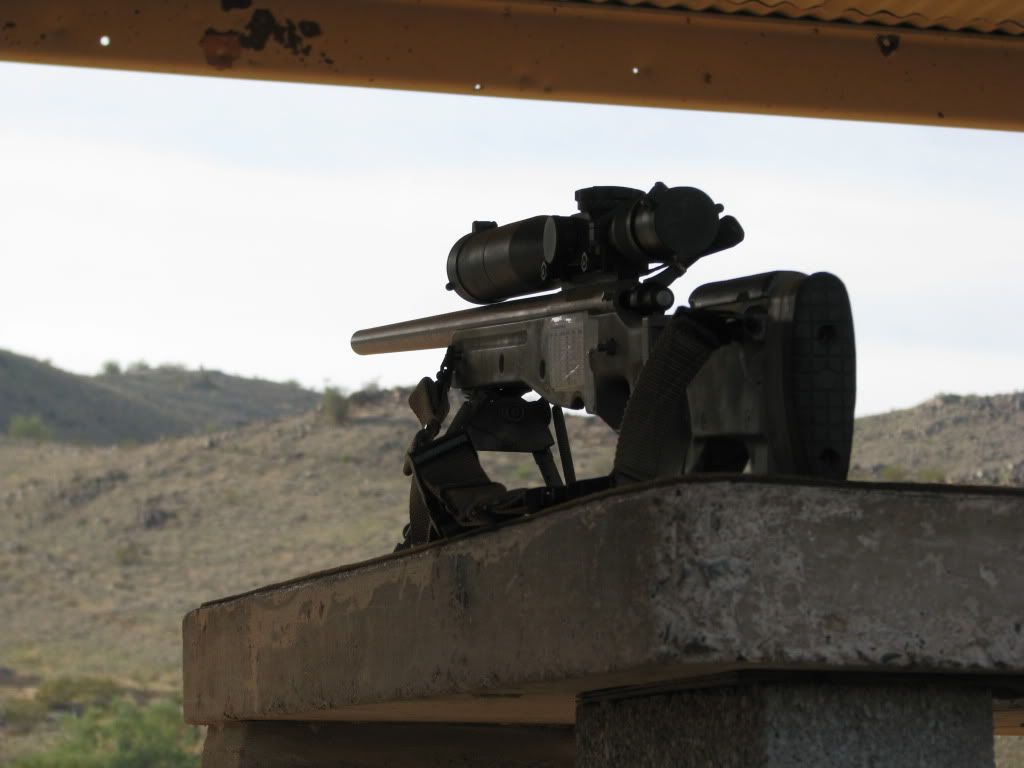

            Dane and I ended up splitting it two ways because we really wanted it and had two comp guns that needed to be re-barreled. We got tired of dealing with shops and smiths. Here is some of what we have been doing with it.
            7mm SAUM ELR rifle.

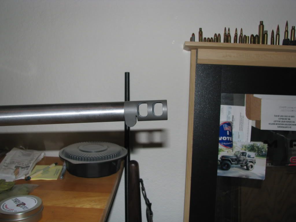

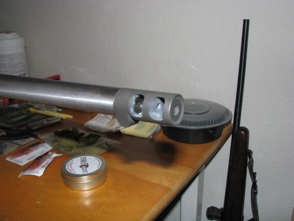

            R+D RAD brake on my match rifle.

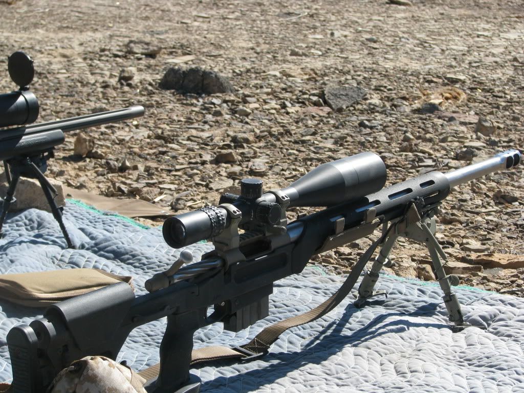

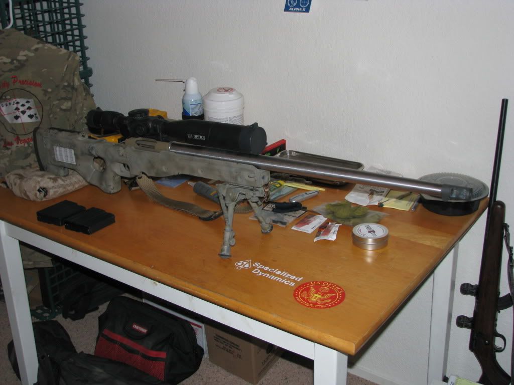

            My match rifle (now sits in a McRee chassis)

              Dane's match rifle (now in a McRee chassis)
              We've also built a 6.5 CM match rifle for our team mate Beau and set back an existing barrel for a friend. We've done a good amount of threads for brakes, suppressors and chambering actions. We are still working on gathering the tooling for truing actions. My team mates and I have been working on standardizing our competition rifles. We will eventually all have the same load, dope, bore/scope axis, chassis and of course we all shot MOA/MOA scopes.

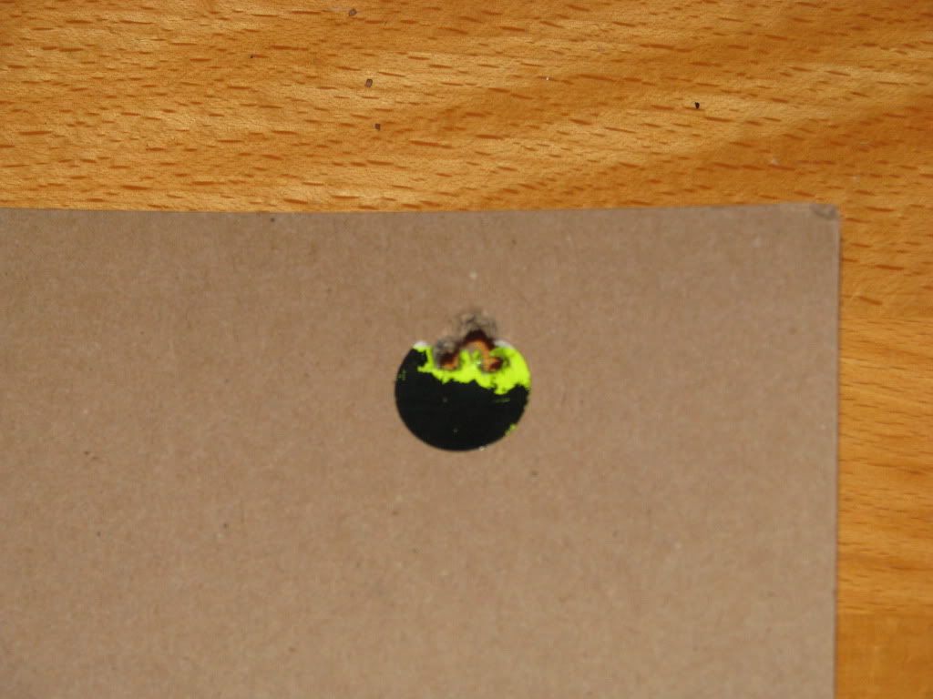

                We are very happy that all the rifles Dane and I have built shoot extremely well!
