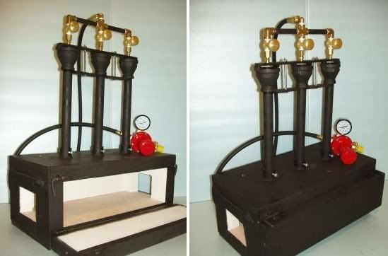

I have one of these bad boys from the ebay store below that I used to use for making knives from railroad spikes.. for fun.. (Short-lived hobby).
I have the 3-burner propane forge. It can run off a regular bbq-style propane tank and I suspect can easily be used for eat treating AK receivers.
I would be interested in an LA Area build party so I can finally put some attention to my Romy G parts kit.. It would be my first build, but I have much of the tools needed (minus the bending jigs and other "specialty" stuff)Comment
To treat an AK with a gas forge, you need to choke the venturis to richen the feed, keep the pressure low, and ideally, wrap the receivers in stainless foil. Oxidizing heat will damage the receiver in a hurry due to the thinness of the material.
It can be done, just be gentle. Fast heating would be bad, and cause warpage.
An electric kiln/furnace is best.Comment
Thanks for the reply.To treat an AK with a gas forge, you need to choke the venturis to richen the feed, keep the pressure low, and ideally, wrap the receivers in stainless foil. Oxidizing heat will damage the receiver in a hurry due to the thinness of the material.
I always wondered about the oxidation and warping factor of the sheet-like receiver steel.
To anyone's knowledge, would any type of annealing be beneficial? I.E. would an entire hardened receiver be too brittle (VS just local hardening, like with a torch).Comment
Given the thin cross-section and medium carbon content, I've found them to strengthen nicely during quench--probably a bainite content without needing to temper. I went ahead and tempered slightly anyway, just to be safe.
The Eastern Bloc receiver are MUCH harder, probably Rc 52 or so, a hard spring temper.Comment
