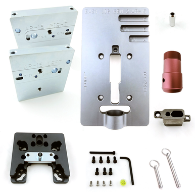

    Hey guys so I was at my LGS and I ordered the Juggernaut Ultimate Jig. I received it today and am now wondering if the top plate/trigger pocket template is too small of a platform for my router? For you guys who have experience completing 80%'s, what do you think? Heres the jig.
    Craft premium AR-10/AR-15 lowers with our Ultimate Jig. Comes with alignment tool, steel bushings, depth gauge, and optional tooling. Made in the USA.
    The 80% Easy Jig has the Router Base that looks a lot easier to keep my router flat on.
    Shop through our selection of replacement parts for the Easy Jig® Gen 2 right here! 80 Percent Arms offers a range of parts to fix problems on your router jig.
    Am I making a bigger deal about this than necessary?

      You could make it work if you are careful not to tilt your router by going too far to one side or another, or the edges. The huge top plate by 80% Arms is a definitely plus in the routing operation by keeping the router level. I have used it many times now and it is a great jig.
      IMO, return the Juggernaut and get the 80% jig instead. I'm within driving distance to 80% Arms and they're a great bunch of guys and take care of their customers.

        Thats kind of what Im thinking. Im gonna return it. Thanks for the help, gents.

            So I did return the Juggernaut and got the 80% Easy Jig instead. Haven't used it yet since I needed to order a few things that I didn't already have and that I couldnt find at home depot like cutting fluid and the rubber vice jaws with magnets to stick to my vice.
            Once those are here, I am going to start spending a lot of time in the garage again lol
