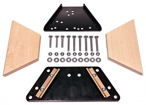

            Couple of observations for ya about your reloading bench. A Dillion 650 does not like flex. Powder will spill and you will have to shut down until you clean it up or it will not work smoothly.
            A basic test for a reloading bench is that you can stand on it and wiggle like youre twerking and it will not move.
            I reloaded in an apt. for many years before getting a house. I used a round table about 3' in dia. I put a 3/4" piece of plywood on top bolted with countersunk bolts and const. adhesive. I drilled holes for my press and measure, put the scale on a shelf eyeball level and loaded thousands of single stage rounds.
            When not loading, I had the press in a box in the closet and threw a table cloth over the table to hid the bolts and holes. I put the table in a corner of the living room and it worked well.
            I cannot repeat it enough that if there is any movement/flex in your table or bench it will be frustrating. FL sizing will be a problem and your scale will be erratic.
            Look into the LEE PRECISION BENCH. They recommend you hang a cinder block off of it for stability. Their quick change mount is awesome but dont even consider the wood blocks. They split. Get the steel. Hope I helped you with this decision.

                I finally bought a Lee Pro 1000 (affordability went south). I took all of your advice and bought a Craftsman Workbench.
                I will be using Lee Bench Plate so that I can switch between my single stage and Pro 1000.
