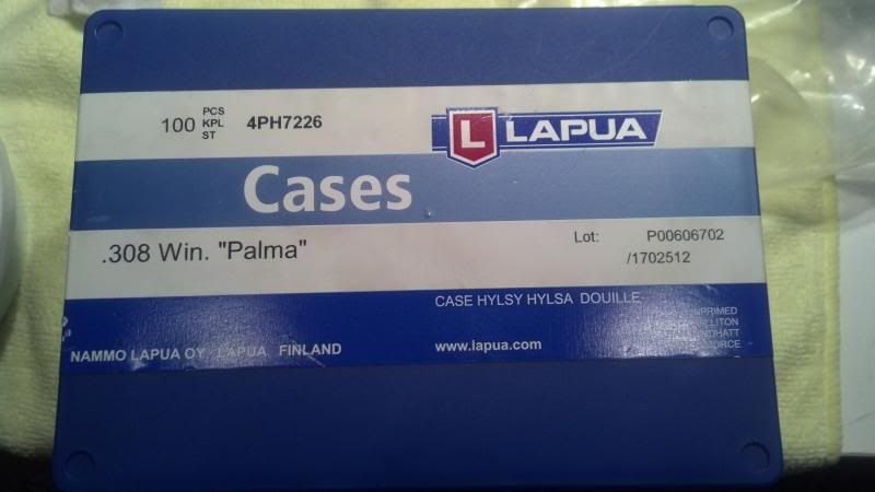

                  Winchester works just as well. To be consistent, each will take some case preparation. If going with Lapua, might as well step up to the small primer (Palma) cases then.

                    What's the difference on the Palma cases?

                        They use small rifle primers instead of the normal LRP:

                              Since its a pain to sort primers for consistency, it is thought if you use SRP's there's less potential for inconsistencies in ignition of the primer as compered to LRP.
