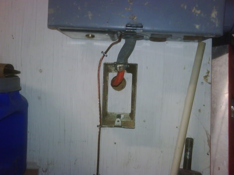

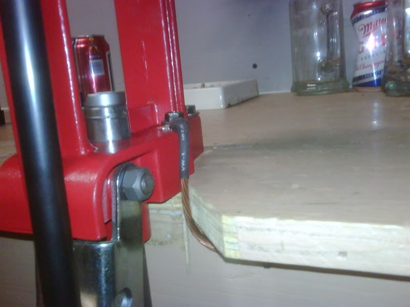

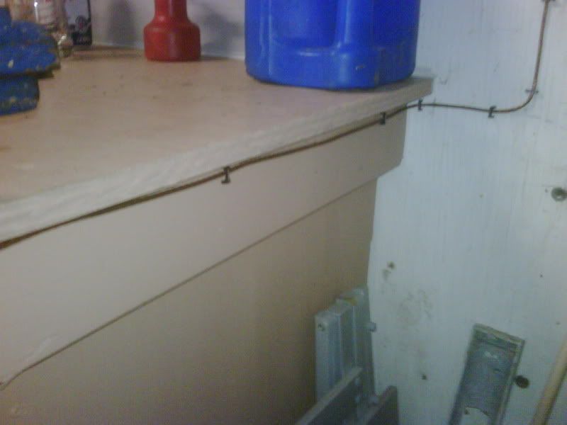

              In my case, my press is mounted to a bench located in a shed. The electrical subpanel that feeds the shed is located right next to the bench. One day, I was bored and happened to have a scrap of #8 bare copper wire, so connected it from the press to the ground bus bar in the panel.
              The ground bus in the panel is connected with #6 wire to the main panel, which is grounded by two 5/8" ground rods driven 8" deep.

                        No need on the ground wire. If anything, there is a little bit of resistance in the wire. I forget what the specific resistivity of #8 bare copper is.
                        Dutch's setup is perfect, albeit a bit overkill but better safe than sorry.
                        Dutch, did you grind the paint off the press where the grounding screw/washer is ?
