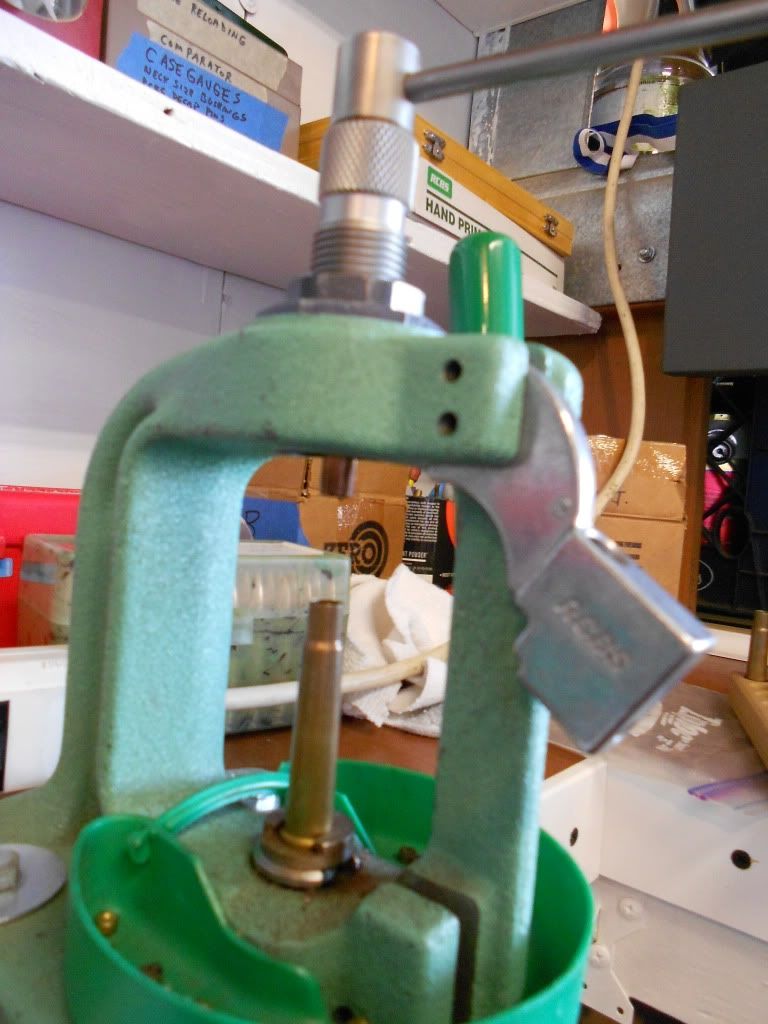

    Most new reloaders but an impact or "Kinetic" bullet puller. After breaking a couple ( & no I didn't screw up that many reloads) , I did screw up & decided there had to be a better way to pull bullets. And Yes Shirley, There is a better way! ( If you have a single stage press handy)
    The RCBS Collet Bullet Puller!
    They are also made by Hornady & a couple others, BTW. But I bought the RCBS brand & over time got the collets for all the sizes I reload.
    Today I pulled bullets from 15- .303 rounds that were corrosive milsurp. In less than 4 minutes I pulled 15 bullets. I've pulled more in less time w/ non-military rounds. So much simpler than the Kinetic style. I still have one, but if I have more than one bullet to pull, I'll use the Collet style.

    Here is the puller installed. Raise the shell up till the bullet goes in the collet. Tighten the collet down. Lower the shell & pop goes the bullet. Loosen collet to retrieve bullet. You can reload the bullet in most cases. These were Bi-metal & not allowed at my range, so I tossed them. Once in awhile it might take 2 tries. YMMV

        Yup, the collet puller is the way to go if you need to pull more than a couple.

          I have collet and kinetic pullers.
          They each have there place. I tried pulling some 9mm with the collet puller and couldn't get a good enough grip on the bullet.

                THIS collet one is only good for about ONE caliber. If they made one that was good for about everything with only 5 collets to buy that would be great but if I want to pull .45 then it will cost another $15.00 and if I want to pull .25 it will cost another $15.00. Ya see where this is gonna go? I am going to be reloading for 5+ calibers but I will take apart anything I come across and use the bullets or melt the lead and use the powder to blow up anthills..
                If you only want to use this to pull the rounds that you reload then it may work great for you, but for tweakers and those of us that like to take things apart then the kinetic is probably a better choice.

                      I have used the RCBS collet puller for a long time. It works great for pulling jacketed bullets.
                      I recently bought an RCBS inertia puller (hammer style) as my collet puller damages lead and plated bullets too much for my taste. The RCBS hammer style puller has a foam pad where the bullet lands, so the softer lead and plated bullets come out undamaged (not counting any sizing the brass has put on them). Finally, if you are pulling wadcutters, the hammer style is really your only option.

                          I DO see enormous value in the collet if i wanted a lower risk way to seat bullets longer without losing the powder. Reseated 5 factory rounds just off the lands like this and started with 20 cause 5 of them I accidentally went too far and popped the bullet out completely, spilling the powder.
                          wouldnt have been an issue with a collet.
                          other that that, my only gripe is I tend to wear out the collets on kinetic pullers with non rimmed cartridges. And no, I dont pull many either. Just not a one size fits all product and is trying to be.

                              I have a disc puller for my Forster press -- fast, neat and easy. Run the round up into the disc and a flat, four-finger metal spring grabs it when you reverse the ram. Just keep going as the next round pushes the pulled bullet free.
