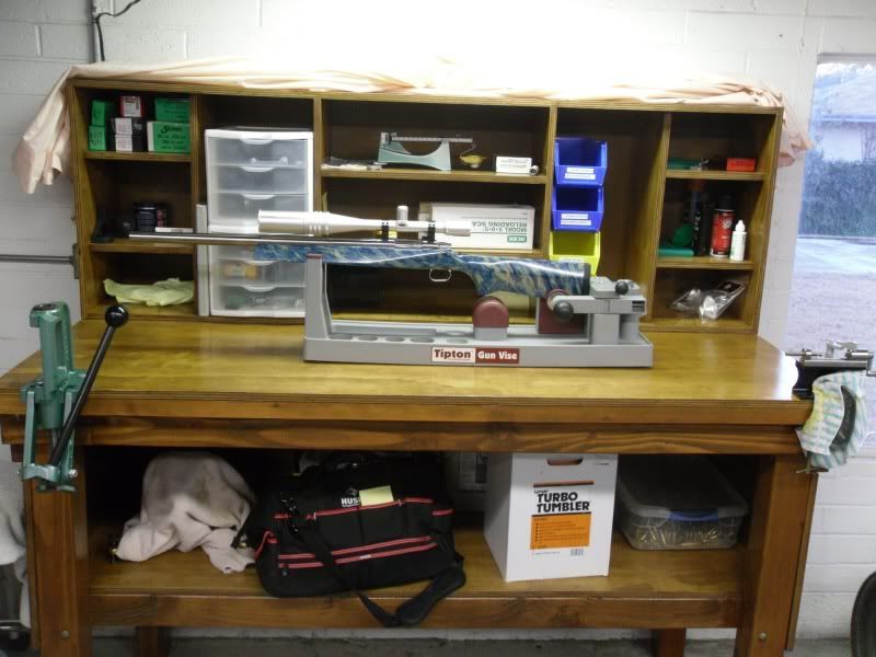

                  I decided on the NRMA reloading bench as already advertised in this thread: here
                  It has been FANTASTIC for me. Spent a while building it, and opted for cabinet grade plywood to make it a little nicer, and did a MDF-type material for the backboard.
                  Also decided not to do the doors and for me that was a good choice. Went with some stain and a polyurethane coat and it came out really nice. It's hefty, couldn't move it if I tried. Hope this has helped some.
