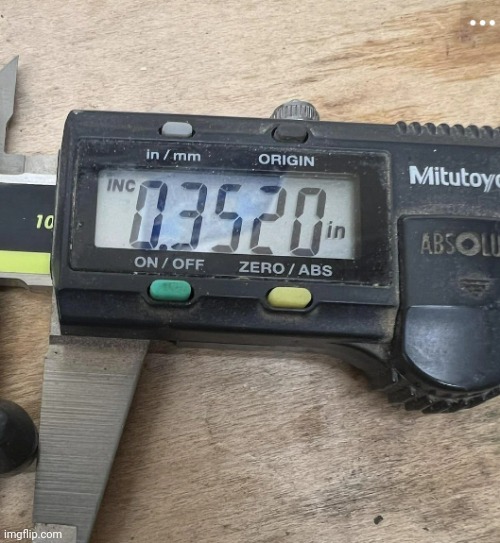

        Well hot dog!!
        Here’s what I got. I grabbed a handful and found three cbc. They’re on the left.
        New bullet measured .3555
        Pulled bullet from cbc. Yikes.
        Picture of cbc pulled bullet
        Pulled bullet from pmc case measured .3555
        Case solved right?? From the info I’ve gotten and couple bullets I’ve pulled it seems like you guys are spot on. CBC brass got me?

                Lead bullets should be sized at least .001" over bore size. You should slug the bore. Which means driving a lead bullet/slug/fishing weight down your bore, then measuring. Preferable with a mic, but a caliper will do. So, you need to start with something that measure at least .359". A 3/8" fishing weight will work.
                Are those bullets cast? Or are they swaged lead? Swaged lead is much softer than cast, and definatly needs to be size larger than the bore. Undersized bullets will strip out in the bore, and key hole. Generally soft lead can be scratched with a fingernail, or thumbnail.
                Most of the aftermarket American made 9mm barrels I have used slug at .356"+. So, that means going with at least a .357" bullet. The only ones that are close to the "nominal" .355" of the 9mm have been Rock Island barrels.
                Slug your bore, then order the correct bullet diameter and go from there.

                    A lead bullet that is undersized will not get a good grip on the rifling, and the lead may strip off in the barrel. The bullet may not spin well,or spin at all, and lead will collect in the lands and grooves of the barrel. A lead bullet that is close in size may work if the pressures are high enough to upset(swell) the base of the bullet to seal the bore.
                    Some lead bullet manufacturers(Speer, for example) use a soft lead alloy that is swaged(pressed) into shape, and then coated some form a soft(probably liquid) lube. Because they are soft, there is a velocity limitation for them. Shooting them too hot can also strip the lead out, and cause key holing. I speak from personal experience.
                    Most of those manufacturers, who supply lead bullets, use cast bullets. Cast bullet normally use a hard alloy and can be driven to higher velocities. Some of the manufacturers offer the bullets in different diameters to give a choice for barrel fit.
                    If you have bullets that are .352", you will not have good results. So, slug your barrel, and then go about .001" over the bore diameter.
