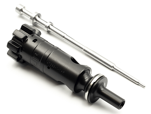

Just buy this and be done with it. I am running this on my 6.5 Creedmoor and am pushing 140g 2850FPS without any pressure signs worth mentioning.
OP is running an FN SPR, not a gas gun.Just buy this and be done with it. I am running this on my 6.5 Creedmoor and am pushing 140g 2850FPS without any pressure signs worth mentioning.
http://jprifles.com/buy.php?item=JPEB-308HP
