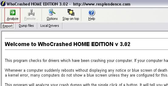

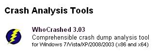

Get the program whocrashed.
about 2/3 down the page...
Run the program by opening it up and clicking analyze
After it analyzes your system, it will give you a minidump...and will show you the last several crashes and what caused them.
you will be able to copy and paste them to here if you want someone to see what's causing your problem.Colt: the original point and click interface.Comment

so, here is what whocrashed told me:
I downloaded and installed processor drivers. still no dice.On Tue 1/17/2012 3
35 AM GMT your computer crashed
crash dump file: C:\WINDOWS\Minidump\Mini011612-03.dmp
This was probably caused by the following module: amdk8.sys (AmdK8+0x3552)
Bugcheck code: 0x1000000A (0x0, 0xFF, 0x0, 0xFFFFFFFF806E5EA0)
Error: CUSTOM_ERROR
file path: C:\WINDOWS\system32\drivers\amdk8.sys
product: AMD Processor Driver
company: Advanced Micro Devices
description: AMD Processor Driver
A third party driver was identified as the probable root cause of this system error. It is suggested you look for an update for the following driver: amdk8.sys (AMD Processor Driver, Advanced Micro Devices).
Google query: amdk8.sys Advanced Micro Devices CUSTOM_ERROROriginally posted by MelvinoelGreat**My friend, your Chargers sure are looking good tonight. They are only losing by 14 at the half, not to bad my friend.Comment
