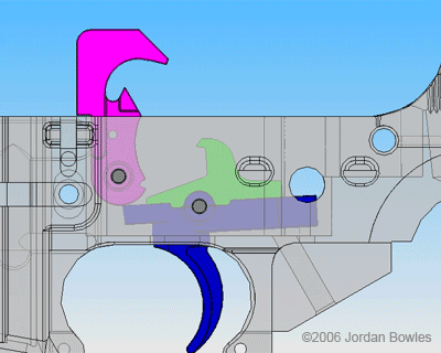

                eta: Here's a gif of the action we're looking at.
                w/ gun unloaded, selector on fire, pulling the trigger should drop the hammer, while continuing to pull the trigger back you manually pull the hammer back, the disconnector should grab the hammer, then you release the trigger and the disconnector should let go and the trigger engage the hammer.
                Are you saying "the disconnector doesn't let go of the hammer" or "the disconnector let's go of the hammer and the trigger engages the hammer at which point, the trigger will NOT release the hammer"? It can only be one of those two, anything else and the hammer would just be flying forward.
