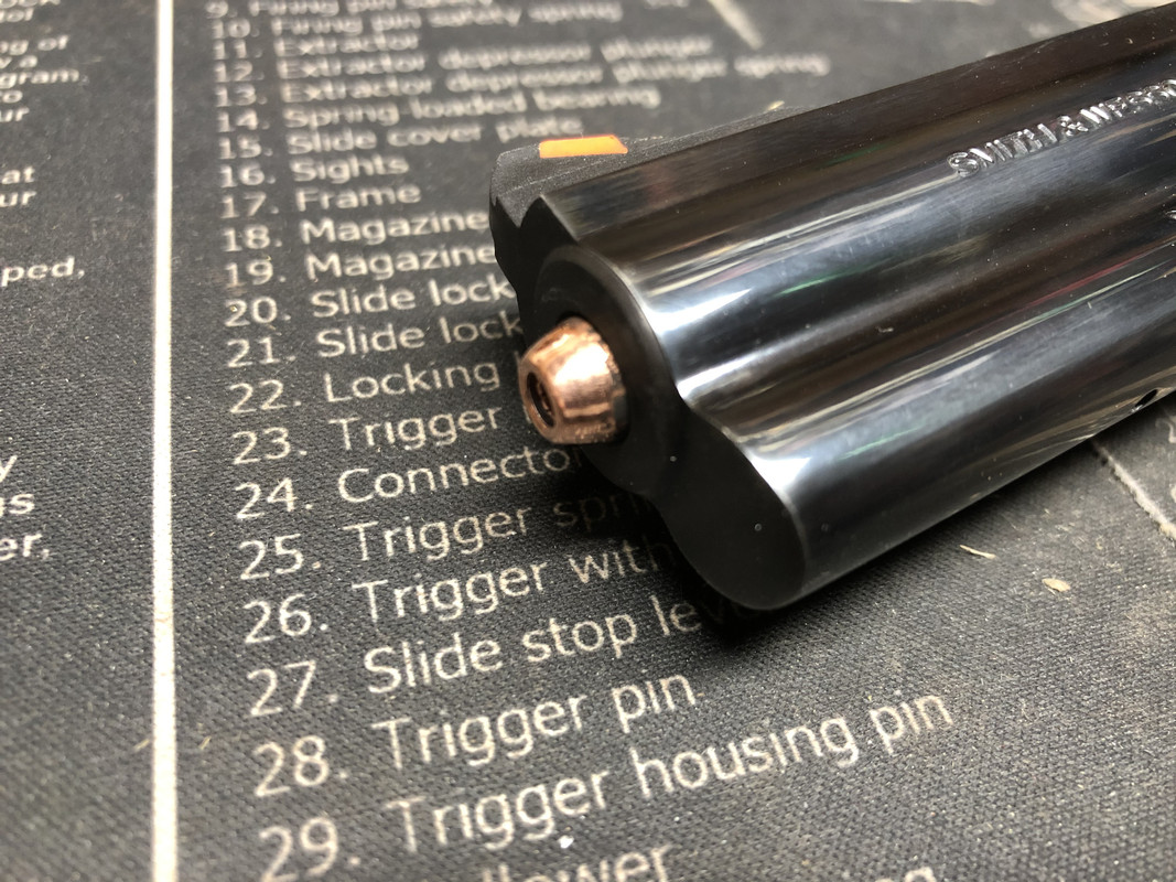

    FIRST TEACHABLE MOMENT:
    I was developing light loads, but not that light. I am positive there was powder in the case. I dropped the powder from a single stage press, then using a flashlight, checked every case to ensure no missing powder or double charges. I was very very careful loading these because they were going to be for the wife.
    What am I missing?
    Any HELPFUL advice is appreciated. All other advice, well, . . . . fine. I dish it out. I can take it.

      What was you powder and how many grains, according to the reloading manual? That looks like a no-powder situation.
      I did the same thing with a .45 Auto barrel. I loaded them, thought I'd been careful but I missed a case and bulged the barrel.

                  What was the load you were testing? Bullet weight? Powder? Charge weight?
                  When there's a lot of empty space and not a lot of powder in the case, the flash from the primer does not always ignite the powder consistently.
                  It depends on where the pile of powder is sitting in the case: up against the flash hole / distributed along the bottom / up against the bullet.
                  Search for "38 special powder position sensitivity" and you will see there's a lot of discussion about this phenomenon.

                    Originally posted by Avocado Toast
                    Nice looking M10 or 13! It has character and personality. Those are a treasure when you have one.
                    I checked for bulge. None.
                      Sir Toast
                      • 3140
                      I will go pull a bullet, weigh it and weigh the powder and give you an accurate answer. BRB
                      Okay, so I just pulled two bullets.
                      Both bullets weighed 158 grains.
                      I had 3.2 grains of powder. I think it is Titegroup.
