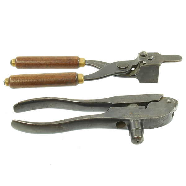

                          A Lyman 310 tool with dies for 44-40 would be my choice for reloading if you?re only interested in that one cartridge. The ammo exists and can be special ordered, but it?s expensiveish and annoying to get. Lyman 310s aren?t cheap but they?re really easy to use and easy to store unlike a bench mounted press. A lee hand press is similar but a bit larger and more affordable.
