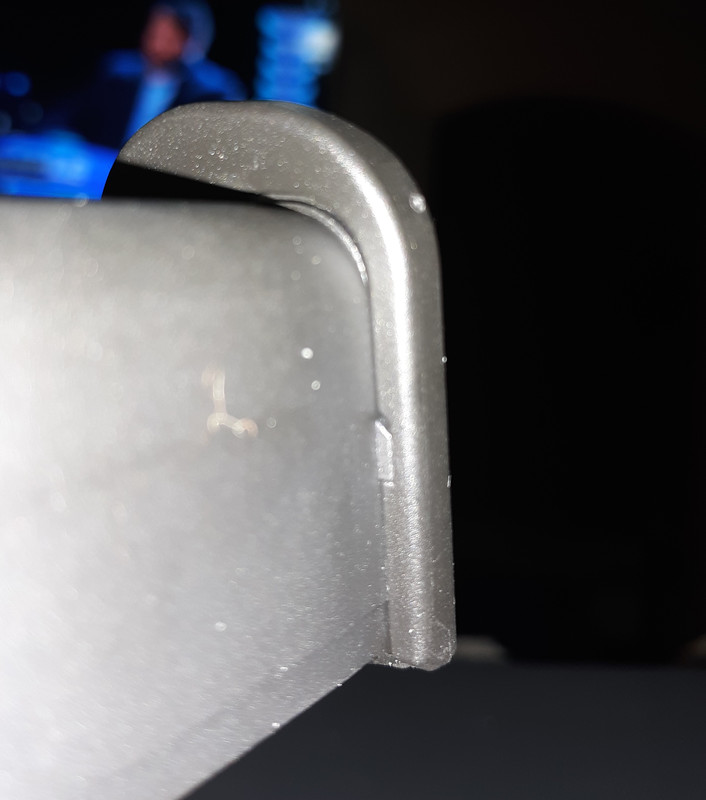

            Spyder, thanks for your help - first time Glock owner and i've never had to deal with their magazine - it's definitely different from any other i've had
            i have a new G19 gen5 and the magazine has a sort of catch that sticks out and creates an interference if you try to pull it out of it's track - many seem to be familiar with it so im guessing it's been around a spell
            it looks like this - are you saying it can be removed in the same manner you mentioned? I read some earlier model Glocks magazines don't have that
            i like the reply from riewpolar too - seems plausible
            what purpose does it really serve, the base plate isn't going to slide off without it - seems like overkill on the design

                    Falconlair, yes, they all have that tab and they are all very easy to take apart. See the above video. It takes him 1 minute to describe what takes 3 seconds to do.
                    Glock mags are easier than AR mags. I have done it literally thousands of times on hundreds of mags. It doesn't hurt them at all. Putting them in a vice is more damaging.

                                so i took a pair of channel locks, protected the magazine body with a soft cloth, depressed the spring about an inch with my punch then applied slight pressure around the bottom of the magazine with the channel locks and the base slid right off - pretty easy, still those little notches seem a bit overboard
                                all in all turned out fine
