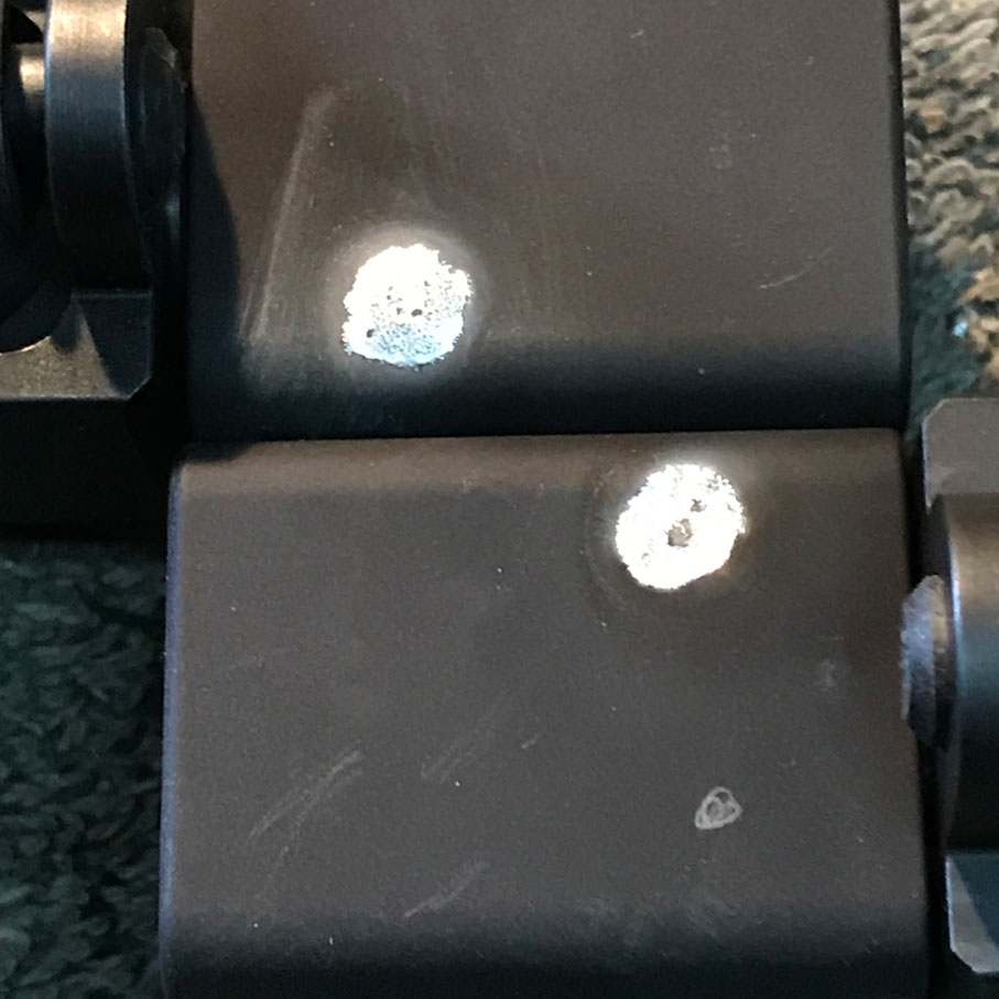

        A threaded barrel with a muzzle device pinned & welded is no longer considered a threaded barrel.
        It's no problem to build a new top end with a comp perm attached on the barrel.

          Loctite does not meet the established legal guidelines for permanent attachment.

          Here are a couple of aluminum comps that I pinned/welded on glock barrels:

                Their only definition of "permanently attached" refers to magazines, but one could infer the same definition (in CCR5471) to apply to muzzle devices since it is defined as:
                (w) “Permanently attached to” means the magazine is welded, epoxied, or riveted into the magazine well. A firearm with a magazine housed in a sealed magazine well and then welded, epoxied, or riveted into the sealed magazine well meets the definition of “permanently attached to”.
                So I would reasonably conclude the DoJ to define a "permanently attached" muzzle device to be one which is "welded, epoxied, or riveted" on to the barrel.

                    During the 94 AW ban, permanent attaching a muzzle device was a legal way to eliminate the threads on a barrel.
                    Many manufacturers did this as a standard practice until the sunset of the AWB in 2004.

                        Look at that ca compliant pistol with the epoxied barrel nut. Seems like it would be hard to get stuck with that charge with that as a comparison. If you ever even found yourself charged with it. Can’t imagine what you’d have to do for DOJ to get ahold of your compensated Glock and start removing loctite and wrenching on it.
                        When you talk to them, they will tell you that the federal guidelines are acceptable.
                        Get your own determination letter if you think that Loctite is good enough.
                        Nobody else has been allowed to use Loctite other than when the DOJ screwed up and made manufacturers put Loctite on the muzzle caps to fix the DOJ screwup.
                        The test for permanence is to wrench off a muzzle device with brute force and see if the barrel gets destroyed.
                        If the barrel is destroyed, then the job was considered acceptably permanent.
                        If the barrel is not destroyed, then the job was not considered permanent.
                        Loctite and epoxy fail the permanence test.
