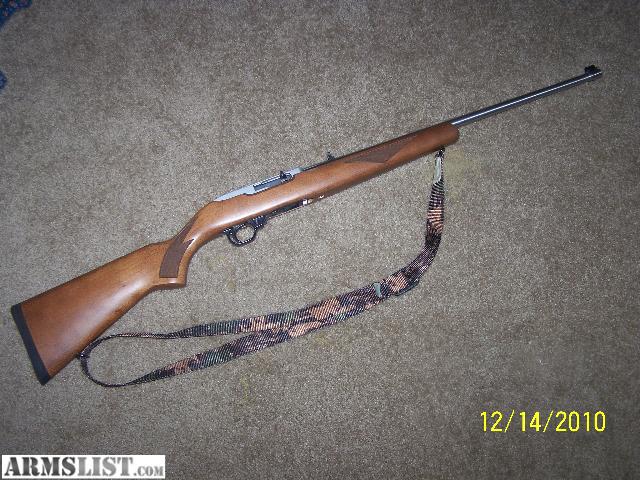

    Gents wanted to run this by you. My wife's 10/22 is having all sorts of stovepipe fte issues and its maddening.
    Model is the Dealer exclusive with the 20" stainless barrel...this one basically
    It without any sort of rhyme or reason will just start stovepiping 1-2 rds out of a 10 rd mag. I have replaced the extractor and spring with new ruger factory parts and we thought we had it but its back to it's old shenanigans.
    We have tried all sorts of different ammo from aquila to cci Mini-mags. It seems to do it less on the HV stuff (think remington golden bullet HV, CCI mini-mag, etc) Last night my wife was shooting Federal auto match and was getting jams multiple times per mag. I shot a bunch and also got jams. I loaded up 60 rds of remington golden bullet HV and not a single jam but the moment i loaded up 10 auto match rounds i got a jam on shot 8 of 10.
    I am wondering what else i should try. Somebody at the range last night thought that the recoil spring could be too stiff and on the standard velocity it wasnt kicking back hard enough where on the HV stuff it was. Thoughts on that? It seems plausible as the golden bullet stuff was HV and i had no issues where the auto match was standard. I was thinking about replacing the guide rod and springs with the KIDD kit and running a 10% reduced power spring. Past that what else could I try? We keep the 10/22 as clean as possible so I don't think its jamming from fouling. Perhaps I should take some steel wool or emory paper to the inside of the receiver to smooth it out? Rifle has probably between 700-800 rounds through it easily so it should be broken in...
