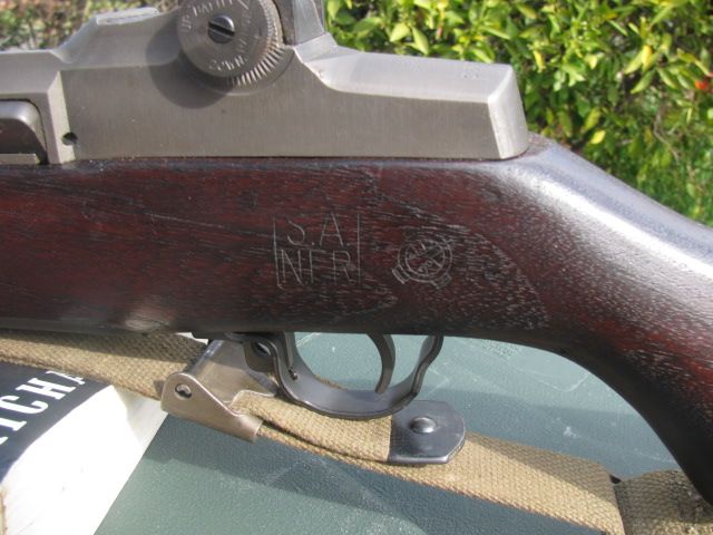

      An example of a barrel date, just pull the op rod back and look:
