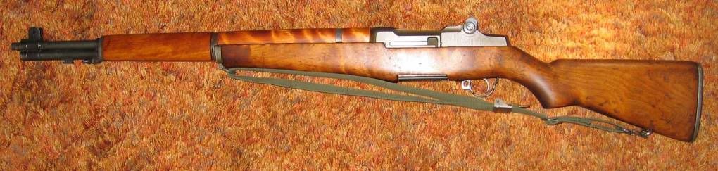

                    Nice rifle! Mine has a 1945 dated barrel matching the production date, so not shot much until it went through Letterkenny AD in1966 for an overhaul.

                      Originally posted by aghauler
                      Yikes twinsies!
                      Triplets! I got this International harvester from the CMP in the 90s.
                        Nice rifle! That is about the timeframe I got mine from CMP.
