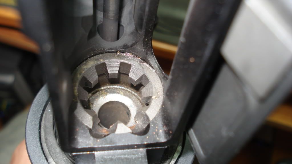

                this was happening to me on my old delton where the feed ramps were not lined up. Check that.

                  thrillhouse700
                  • 4349
                  Like this......

                      dieselpower
                      • 11471
                      Originally posted by thrillhouse700
                      Like this......
                      which is why I advise NOT to get a Upper with M4 cuts unless you plan on buying NFA.
                        My Rock River has M4 cuts and haven't had any feeding issues at all. Maybe try cleaning that thing every now and then? What is that, pocket lint?
                          that's not the fault of the M4 cuts, it just wasn't assembled correctly.
