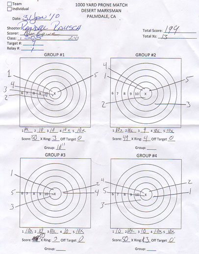

                              ar15barrels
                              • 57171
                              Originally posted by Fjold
                              I never see the posts where these people have actually shot 1,000 yards.
                              Randall Rausch
                              AR work: www.ar15barrels.com
                              • #45
                                Fjold
                                • 23042
                                Randall, you don't post saying that you want to build a long range rifle, you just build them.
                                Frank
                                Life Member NRA, CRPA and SAF
