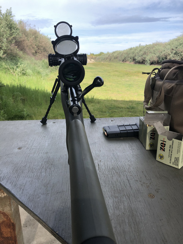

          stormvet
          • 12681
          I’ve never assembled a bolt gun from scratch, but agree the Howa 1500 action is a good solid low cost way to start. Many years ago I bought a Howa 1500 from Buds when they were having a sale, came with a Hogue stock. Certainly not the best but a solid stock for a low cost rifle. They have a nice smooth action and shoot well, capable of small tight groups. Like you I usually just use military type ammo but still get satisfactory results with it.

                            stormvet
                            • 12681
                            You may actually save money or break even just buying a complete Howa rifle. They offer several different target type chassis with the AICS/MDT, along with heavy barrels in 20-24” (my rifle has a heavy 24” barrel). I’ve seen the the Oryx chassis, heavy 20” with box mag and adjustable stock for less than $900.
