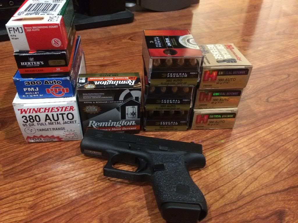

            Ok... tonite was first range visit for my 42. Didn't do a thing to it just loaded up some mags and had at it.
            Here's the ammo I used.
            I fired 2 mags of each box so each of my mags were used for each brand.
            36 rounds down range @ 6 yards first time shooting the gun.
            It was only 6 yards but I was happy with that.
            However the g42 was anything but flawless. It puked all over itself on the blazer. Ftf... fte... stovepipe 12 rounds maybe 2 of them were consecutive.
            The brass max was better. 2 or 3 failures out of 12 rounds
            The wwb ran 100%. It says target on the box and the bullet looks like a wad cutter and I didn't expect it to run at all after what the blazer did but it worked fine.
            Six mags down range and not one locked open on the last round but that's probably on me my thumb tends to land right on the slide lock.
            I'm thinking the recoil spring is stronger than it needs to be, it seems to me that the g42 likes hotter rounds and has problems with lighter loads but that's just my first thought.
            One of the reasons I bought it was I thought my wife and daughter would enjoy shooting it. However it's not as soft shooting as I thought it would be and the slide is a bit on the slippery side and not as easy to rack as I hoped. They haven't tried it yet so that is to be determined.
            So in conclusion, I love everything about it and I like how it shoots but I'd like to make the slide cuts a little deeper and put some front serrations on it too.
            Obviously it was ammo finiky for me but it has a lot of potential and I'll figure it out. Guess I wasn't as lucky as the other posters.
            UPDATE: it's all good see post 25 of this thread

                    UPDATE:
                    second range visit same ammo same mags lubed slide and changed my hold.
                    I ran 14 mags down range and had not one failure of any kind.
                    Slide locked open on last round eveey time.
                    As long as I keep my thumbs off the slide it runs great.
                    It's a pleasure to shoot and for a small gun I do alright with it. I like it a lot.
