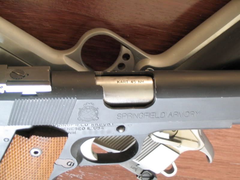

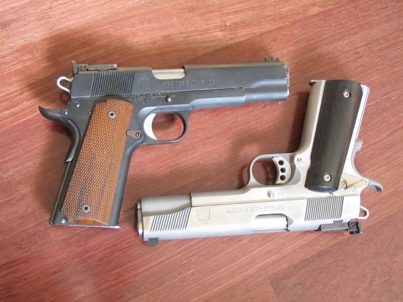

    Gun 1 - Springfield milspec. My goal for this gun was to have an "ugly" using gun with good internals and great accuracy/trigger. Worry about asthetics later. . . I wanted a gun to be able to shoot the crap out of and draw from holster a lot.
    1. Weld up frame rails and fit slide to frame
    2. Install match barrel/bushing (they chose Kart)
    3. Install fiber optic front sight
    4. perform 3 lb. trigger job. (it must've been a nice gritty 8 lb. pull before)
    5. Fix loose Bomar someone else installed.
    6. Fix loose ejector
    7. Crown barrel.
    8. Test fire
    Gun 2 - springfield 9mm loaded 1911 . .. this one is my wife's gun, and it has always run very well. The gun was not up to par in the accuracy department out of the box with shots stringing all over. I didn't want to roll the dice with Springfield's regular service so I thought I'd do it once, do it right:
    1. Standard accuracy job on factory barrel (weld barrel hood and fit)
    2. match bushing.
    3. test fire
    I was a pleasure dealing with George and his team at EGW. They went out of their way to work with my schedule and get the guns back to me in time for class. No regrets, and I know where to go if I need other work done. I highly recommend EGW.

            For Black Talon. . .. . Fine, twist my arm. . . I'll post some pics. I didn't post any prior because there was no cosmetic work done. . . in fact, the black pistol's finish was somewhat damaged, but c'mon . . they welded the frame rails top and bottom. . . and it still came out being ok. That's some meticulous welding if you ask me. I was anticipating a compulsary re-finish, but they went in and surgically did their magic.
            None of the cometic flaws are the result of EGW's work. . . these are pre-existing conditions. (Remember.. . .it's my "ugly" using gun) The Bomar was not installed by EGW, the beavertail was not installed by EGW. All the bling is inside the gun The stainless 9mm gun looks as stock except for the ebony grips which I made and the match bushing.

                  My wife and I just got back from shooting school together this past weekend, and both guns have a whole lot more holster wear but it's nice seeing how confident she is with it now.
                  Both guns ran well, and shot great. . . that stock loaded 9mm is a tack driver now through the stock barrel. I'm a happy camper and the wife is confident with her hostage rescue head shots. Loads of fun.
