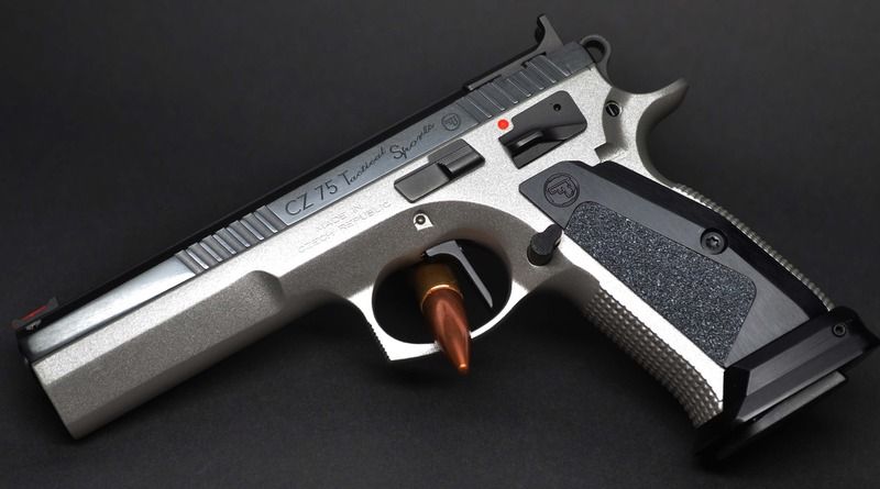

        Originally posted by Litespeeds
        Not a picture of my TS but just changing the grips and magwell makes this gun look bad***.
        Magwell and grips are from CZ USA and made for the Czechmate.
        Well that looks familiar
        Thanks for the kind words. Added the flat trigger, CGW barrel bushing and FO front sight this weekend. I REALLY like this gun
        Link for feedback -
        https://www.calguns.net/calgunforum/...4#post28181454
